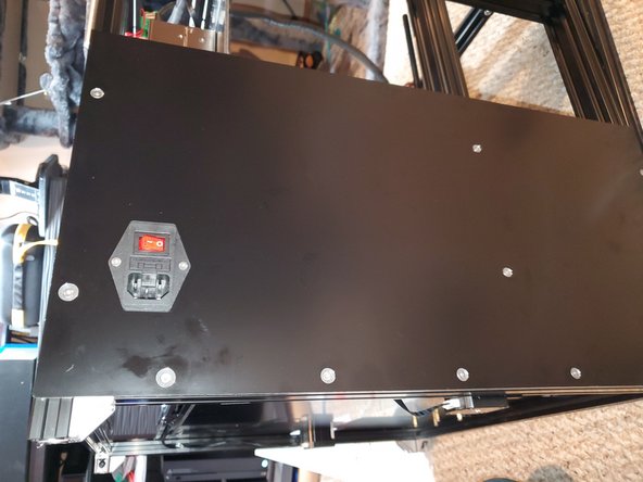

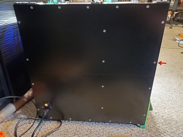

  3. 8. Panel Walls, Left Side Panel: crwdns2935265:03crwdnd2935265:01crwdnd2935265:03crwdne2935265:0 8. Panel Walls, Left Side Panel: crwdns2935265:03crwdnd2935265:02crwdnd2935265:03crwdne2935265:0 8. Panel Walls, Left Side Panel: crwdns2935265:03crwdnd2935265:03crwdnd2935265:03crwdne2935265:0
    • Find the Left side lower half panel that has the hole in it for the power input and switch.
    • Mount the switch to the side panel with 2x M3x8 countersunk screws and 2x M3 nuts
    • Using 11x M3x8 countersunk screws and 11x M3 T-nuts install the left side lower half panel onto the printer
    • Using 11x M3x8 countersunk screws and 11x M3 T-nuts install the left side upper half panel onto the printer
  4. 8. Panel Walls, Right Side Panel: crwdns2935265:04crwdnd2935265:01crwdnd2935265:01crwdne2935265:0
    • Using 11x M3x8 countersunk screws and 11x M3 T-nuts install the right side lower half panel onto the printer
    • Using 11x M3x8 countersunk screws and 11x M3 T-nuts install the right side upper half panel onto the printer
