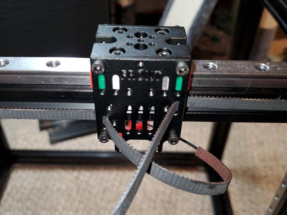

    • The belt lockers that came in the kit are experimental and should not be used. It's been found that they are not strong enough to hold the belts. The zip-tie method is the only recommended method to secure your belts.
    • You should have 1 long belt. Start by cutting it in half. It doesn't have to be exactly in half because you will have extra belt length when finished.
    • Feed the belts through the belt guides on the rear plate. When the rear plate is installed the belt teeth fill be towards the X 2020 extrusion.
    • If you don't want to use superglue move to the next step.
    • For added security I like to use a few drops of superglue(I use Loctite Gel). Fold the belt over so the teeth interlock. The belt only needs to overlap no more than about 1 inch. Using a pair of needle nose pliers to hold the belts for about a minute to give the glue time to set.

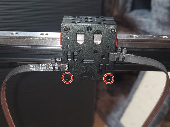

  2. 6. X Carriage and Belts, Belts Rear Plate: crwdns2935265:02crwdnd2935265:01crwdnd2935265:01crwdne2935265:0
    • Using 4 small zip ties, fasten the belt. Give the long end a few tugs to make sure it doesn't slip.
    • Cut the "tail" of the zip-tie off. Do not through these away. We will use them later to help route the belts.

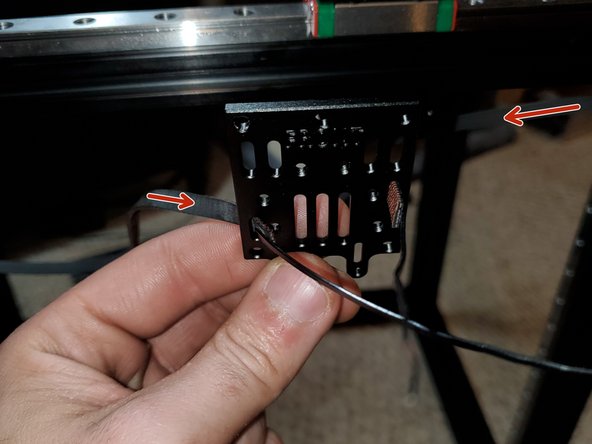

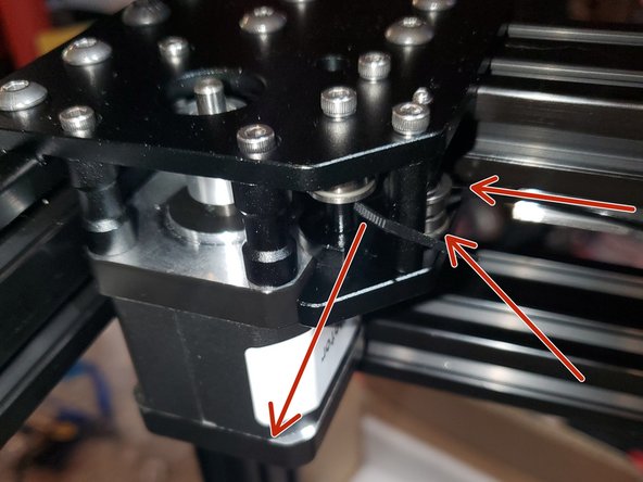

  4. 6. X Carriage and Belts, Belt Routing: crwdns2935265:04crwdnd2935265:01crwdnd2935265:01crwdne2935265:0
    • This step isn't required but it makes it easier to route the belts because it gives you something to grab and you can bend the zip-tie to direct it around the pulleys.
    • Take the zip-tie tails you cut off in step 2. Using superglue, glue the tail to the end of the belt. You don't need more than 10mm of zip-tie glued to the belt.

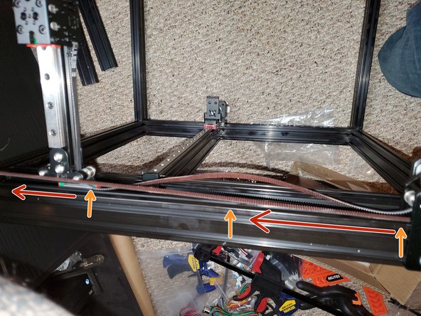

  5. 6. X Carriage and Belts, Belt Routing: crwdns2935265:05crwdnd2935265:01crwdnd2935265:03crwdne2935265:0 6. X Carriage and Belts, Belt Routing: crwdns2935265:05crwdnd2935265:02crwdnd2935265:03crwdne2935265:0 6. X Carriage and Belts, Belt Routing: crwdns2935265:05crwdnd2935265:03crwdnd2935265:03crwdne2935265:0

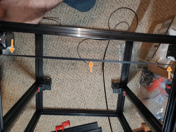

    • Refer to the belt routing PDF in the introduction. Make sure the belt doesn't twist. There's one spot each belt is meant to be flipped otherwise it should be straight.
    • Looking at the back plate(standing behind the printer) take the "lower" belt and feed it to the left
    • With the smooth side of the belt touching the bearing, go around the bearing towards the rear corner.
    • Loop the belt around the lower bearing. The smooth side of the belt will touch the bearing. Pull the belt slack through and towards the other rear corner.

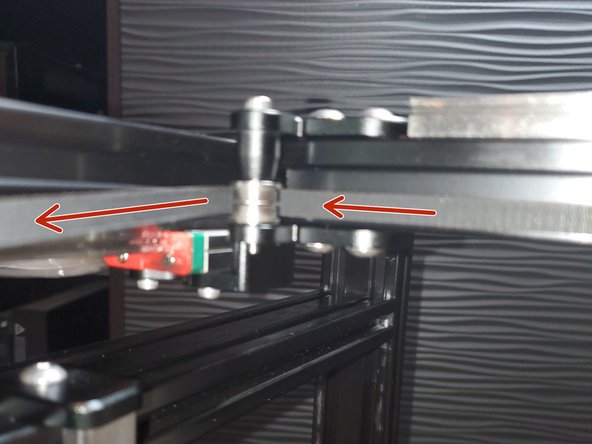

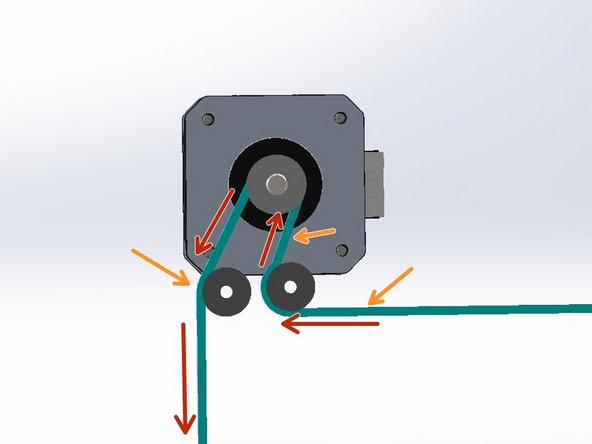

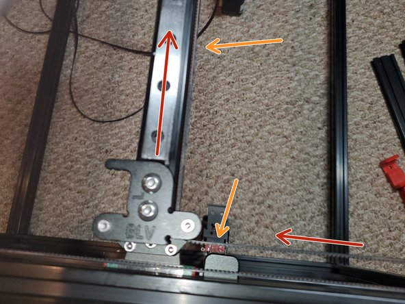

  6. 6. X Carriage and Belts, Belt Routing: crwdns2935265:06crwdnd2935265:01crwdnd2935265:03crwdne2935265:0 6. X Carriage and Belts, Belt Routing: crwdns2935265:06crwdnd2935265:02crwdnd2935265:03crwdne2935265:0 6. X Carriage and Belts, Belt Routing: crwdns2935265:06crwdnd2935265:03crwdnd2935265:03crwdne2935265:0
    • The picture with the red line shows the belt pulled straight through to the other corner. This is incorrect.
    • The belt needs to be rotated 180 degrees
    • The belt is fed through the back corner bearing with the smooth side touching the belt and the teeth facing the rear 2040. Rotate the belt 180 degrees so now the teeth are facing towards the front of the printer.
    • The graphic shows the belt routing into the Left Corner. The red arrows show the direction to feed the belt and the orange indicates the smooth side of the belt

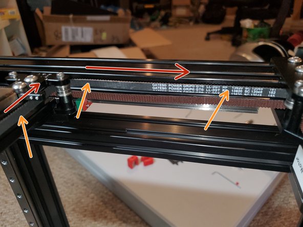

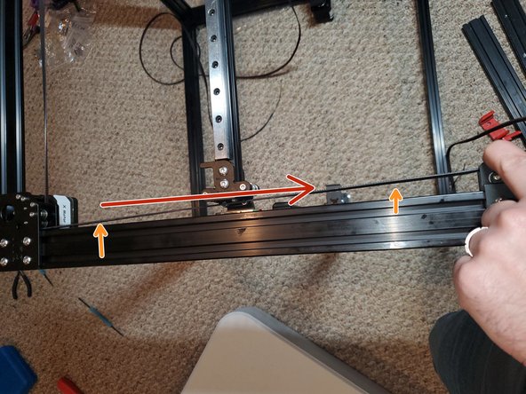

  7. 6. X Carriage and Belts, Belt Routing: crwdns2935265:07crwdnd2935265:01crwdnd2935265:03crwdne2935265:0 6. X Carriage and Belts, Belt Routing: crwdns2935265:07crwdnd2935265:02crwdnd2935265:03crwdne2935265:0 6. X Carriage and Belts, Belt Routing: crwdns2935265:07crwdnd2935265:03crwdnd2935265:03crwdne2935265:0
    • Feed the belt along the 2040 towards the front of the printer
    • Feed the belt through the Left Tensioner. The belt teeth will ride along the bearing
  8. 6. X Carriage and Belts, Belt Routing: crwdns2935265:08crwdnd2935265:01crwdnd2935265:02crwdne2935265:0 6. X Carriage and Belts, Belt Routing: crwdns2935265:08crwdnd2935265:02crwdnd2935265:02crwdne2935265:0
    • Route the belt around the pulley on the Left X Mount. The smooth face of the belt will run on the earing face and the teeth will be towards the 2020.
    • We still have to run the belt through the Front Plate but we will do that at a later step.

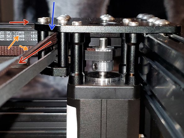

  10. 6. X Carriage and Belts, Belt Routing: crwdns2935265:010crwdnd2935265:01crwdnd2935265:03crwdne2935265:0 6. X Carriage and Belts, Belt Routing: crwdns2935265:010crwdnd2935265:02crwdnd2935265:03crwdne2935265:0 6. X Carriage and Belts, Belt Routing: crwdns2935265:010crwdnd2935265:03crwdnd2935265:03crwdne2935265:0

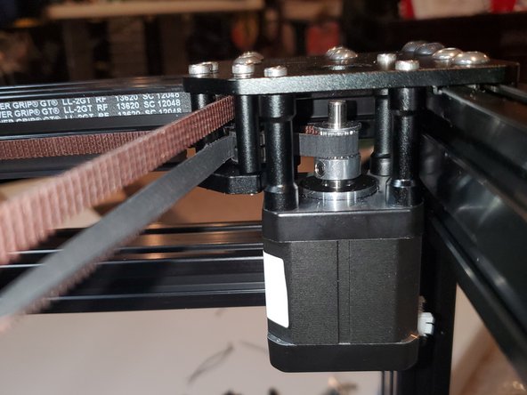

    • Rotate the belt 180 degrees along the rear 2040 so now the teeth are facing towards the front of the printer.

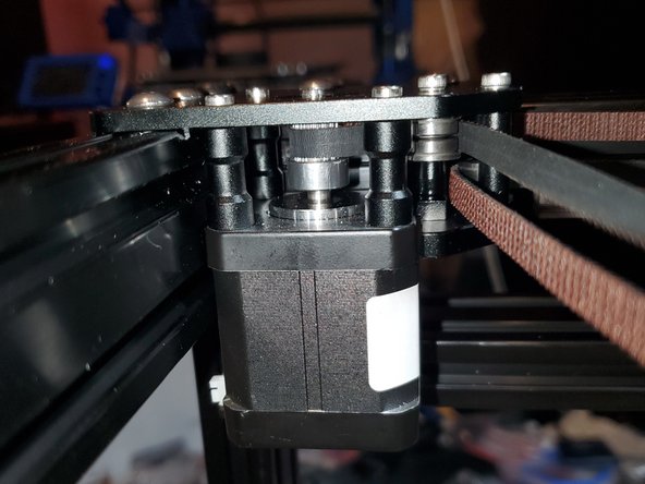

  11. 6. X Carriage and Belts, Belt Routing: crwdns2935265:011crwdnd2935265:01crwdnd2935265:03crwdne2935265:0 6. X Carriage and Belts, Belt Routing: crwdns2935265:011crwdnd2935265:02crwdnd2935265:03crwdne2935265:0 6. X Carriage and Belts, Belt Routing: crwdns2935265:011crwdnd2935265:03crwdnd2935265:03crwdne2935265:0
    • Feed the belt around the bearing so the smooth side face of the belt touches the bearing.
    • The teeth of the belt go around the stepper gear
    • The teeth of the belt will touch the outside bearing
    • Feed the belt along the 2040 to the Right Tensioner. The smooth side of the belt will be towards the 2040.
    • Loop the belt around the Front Tensioner bearing with the teeth against the bearing.

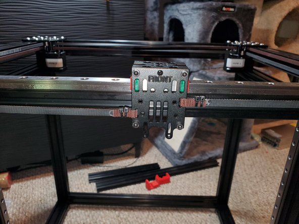

    • Loop the belt around the Right X Mount bearing with the smooth side against the bearing towards the X carriage
    • Take your X Carriage Front Plate and feed the belts through their openings. The "lower" belt feeds into the left and the "upper" feeds into the right.
    • Be sure to route the belt through the back of the Front Plate pulling out any slack in the belt loop.
    • Secure the Front Plate to the Top Block and the M3x27 standoffs with 4x M3x10 socket head screws.

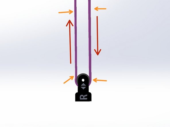

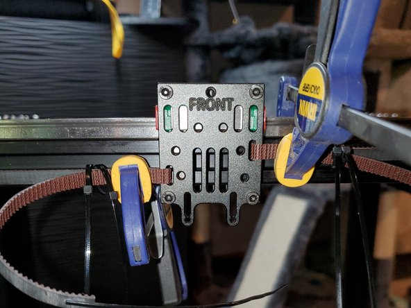

  13. 6. X Carriage and Belts, Belt Locker: crwdns2935265:013crwdnd2935265:01crwdnd2935265:03crwdne2935265:0 6. X Carriage and Belts, Belt Locker: crwdns2935265:013crwdnd2935265:02crwdnd2935265:03crwdne2935265:0 6. X Carriage and Belts, Belt Locker: crwdns2935265:013crwdnd2935265:03crwdnd2935265:03crwdne2935265:0

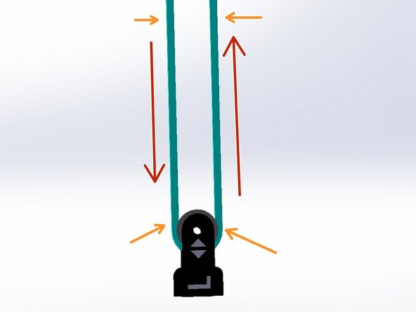

    • When we pull the belts tight to lock them in place we want a little counter tension on the tensioners. Tighten the tensioner knob a few turns until the tensioner looks similar to this.
    • It is not advised to use the belt lockers that come in the metal kit. They are beta parts but the preferred way is zip-ties
    • Pull the belts through the front plate so they're tight. I used a few drops of superglue on the smooth side of the belt.
    • I clamped the belt to the 2020 to give the glue time to dry.
    • Remove the clamps after 5 minutes. Tighten the zip-ties and cut off the tail and the extra belt length.
