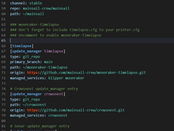

    • If you loaded my config files it should already be included but check moonraker.conf contains:
    • [authorization] under trusted clients contains 127.0.0.1
    • [update manager KlipperScreen]
  3. 6. Installing Klipper Screen: crwdns2935265:03crwdnd2935265:01crwdnd2935265:02crwdne2935265:0 6. Installing Klipper Screen: crwdns2935265:03crwdnd2935265:02crwdnd2935265:02crwdne2935265:0
    • If you used the latest version of Mainsail(v7.0) skip this next command.
    • git clone https://github.com/mainsail-crew/moonrak...
    • Regardless if you used the latest version or not run
    • bash ~/moonraker-timelapse/install.sh
    • Make sure printer.cfg calls the timelapse config
    • [include timelapse.cfg]
    • Make sure the [timelapse] section is uncommented in moonraker.conf
