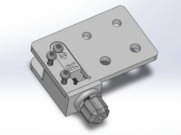

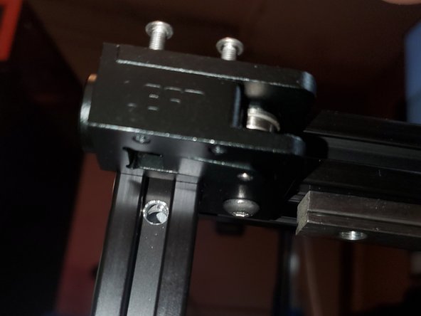

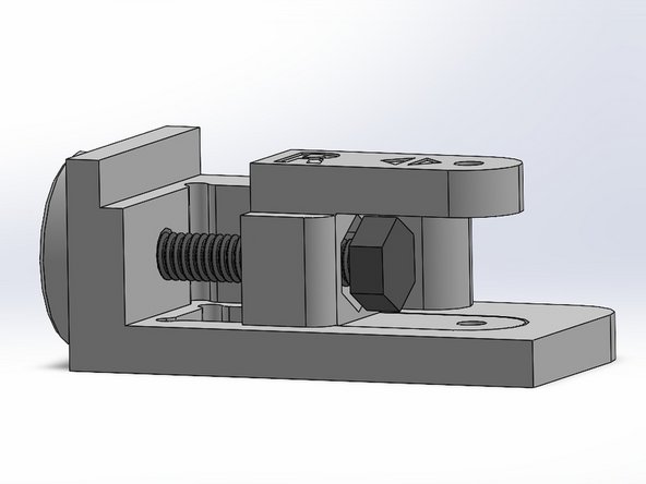

    • Insert the Left Tensioner slide into the Left Bottom Tensioner mount.
    • Insert M4 hex head screw through the Left Tensioner slide.
    • Make the bearing assembly with 3x M3 washers and 2x F623ZZ bearings.
  2. 5. Belt Tensioner Assembly, Left Tensioner Assembly: crwdns2935265:02crwdnd2935265:01crwdnd2935265:03crwdne2935265:0 5. Belt Tensioner Assembly, Left Tensioner Assembly: crwdns2935265:02crwdnd2935265:02crwdnd2935265:03crwdne2935265:0 5. Belt Tensioner Assembly, Left Tensioner Assembly: crwdns2935265:02crwdnd2935265:03crwdnd2935265:03crwdne2935265:0
    • Insert a M3x18 button head screw to secure the bearing assembly to the tensioner slide.
    • Thread the tensioner knob on to the M4 hex head screw
    • Thread the Left Tensioner Top Plate to the bottom assembly with 2x M3x18 button head screws. Do not tighten completely
  3. 5. Belt Tensioner Assembly, Left Tensioner Assembly: crwdns2935265:03crwdnd2935265:01crwdnd2935265:03crwdne2935265:0 5. Belt Tensioner Assembly, Left Tensioner Assembly: crwdns2935265:03crwdnd2935265:02crwdnd2935265:03crwdne2935265:0 5. Belt Tensioner Assembly, Left Tensioner Assembly: crwdns2935265:03crwdnd2935265:03crwdnd2935265:03crwdne2935265:0
    • Mount the assembly to the left top of the frame using 2x M5x8 button head screws, 2x M5 T-Nuts and 2x M6x10 button head screws. Once the plate is straight tighten the screws
    • Tighten the M3x18 button head screws
    • Secure the bottom of the tensioner to the underside of the 2040 with a M5x8 button head screw and M5 T-Nut

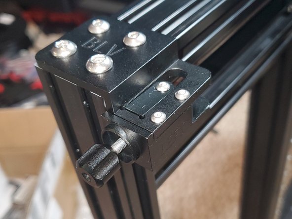

  4. 5. Belt Tensioner Assembly, Right Tensioner Assembly: crwdns2935265:04crwdnd2935265:01crwdnd2935265:03crwdne2935265:0 5. Belt Tensioner Assembly, Right Tensioner Assembly: crwdns2935265:04crwdnd2935265:02crwdnd2935265:03crwdne2935265:0 5. Belt Tensioner Assembly, Right Tensioner Assembly: crwdns2935265:04crwdnd2935265:03crwdnd2935265:03crwdne2935265:0
    • Insert the Right Tensioner slide into the Right Bottom Tensioner mount.
    • Insert M4 hex head screw through the Right Tensioner slide.
  5. 5. Belt Tensioner Assembly, Right Tensioner Assembly: crwdns2935265:05crwdnd2935265:01crwdnd2935265:03crwdne2935265:0 5. Belt Tensioner Assembly, Right Tensioner Assembly: crwdns2935265:05crwdnd2935265:02crwdnd2935265:03crwdne2935265:0 5. Belt Tensioner Assembly, Right Tensioner Assembly: crwdns2935265:05crwdnd2935265:03crwdnd2935265:03crwdne2935265:0
    • Thread the Right Tensioner Top Plate to the bottom assembly with 2x M3x18 button head screws. Do not tighten completely
    • Mount the assembly to the right top of the frame using 2x M5x8 button head screws, 2x M5 T-Nuts and 2x M6x10 button head screws. Once the plate is straight tighten the screws.
