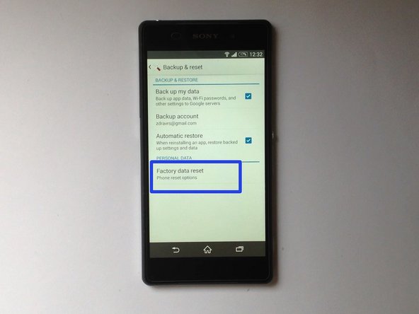

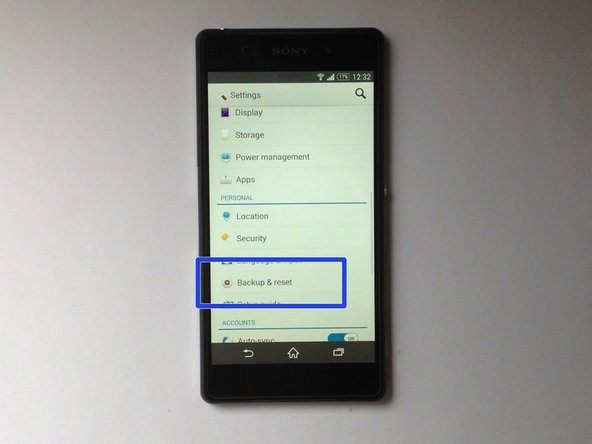

    • HARD RESET - If your device crashes, freezes or if you have a problem with the Android OS, you can perform a Hardware reset. This will delete all personal data and will set the device into factory settings!!!
    • Open Settings menu, then Backup & reset. Now choose Factory data reset.

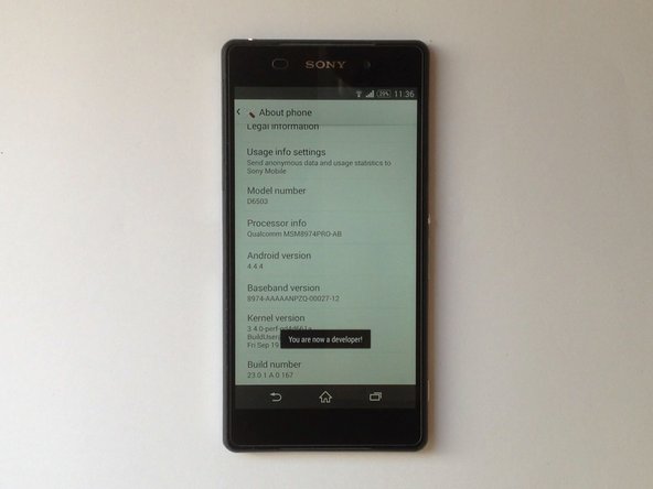

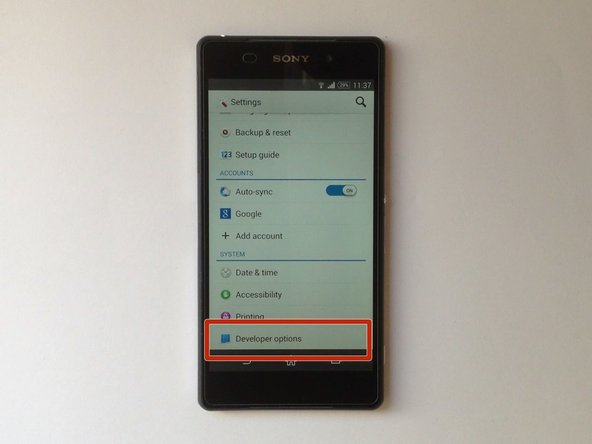

    • DEVELOPER OPTIONS MENU
    • Developer Options have many features for app developer to test an app on their device from PC via ADB. From this menu you can activate USB Debugging mode. On more recent versions of Android, the developer options have been hidden.
    • To enable Developer options, go to Settings - About phone. Navigate to the bottom and you should see Build Number. Now tab it 7 times and ... "You are now a developer." :)

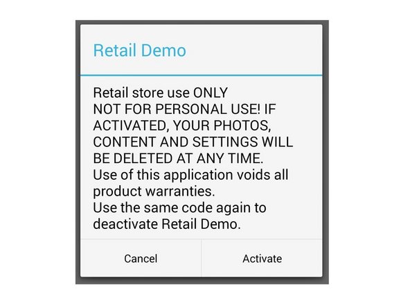

  5. 5 Tips and Tricks, RETAIL DEMO MODE: crwdns2935265:05crwdnd2935265:01crwdnd2935265:03crwdne2935265:0 5 Tips and Tricks, RETAIL DEMO MODE: crwdns2935265:05crwdnd2935265:02crwdnd2935265:03crwdne2935265:0 5 Tips and Tricks, RETAIL DEMO MODE: crwdns2935265:05crwdnd2935265:03crwdnd2935265:03crwdne2935265:0
    • In RETAIL DEMO the phone start demo video and do this every time it goes to sleep mode. Older version of Android have a bug, that allowed to change the screen lock if the phone has Lock screen. For the newer version you can't enter "Retail mode" if the phone is screen locked.
    • To enter and go out this mode, from the Dealer app enter this code:
    • *#*#73556673#*#*
