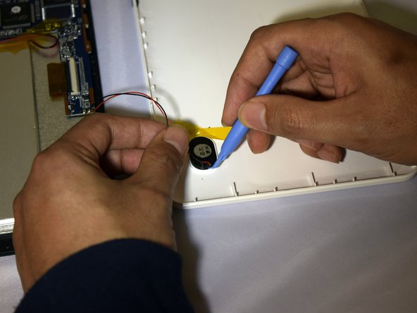

    3. 4Sight 9 Screen Replacement: crwdns2935265:03crwdnd2935265:01crwdnd2935265:02crwdne2935265:0 4Sight 9 Screen Replacement: crwdns2935265:03crwdnd2935265:02crwdnd2935265:02crwdne2935265:0
      • Hold the positive and negative wires as close as possible to the speaker.
      • Use an opening tool and fingers to simultaneously lift the speaker from the cover.

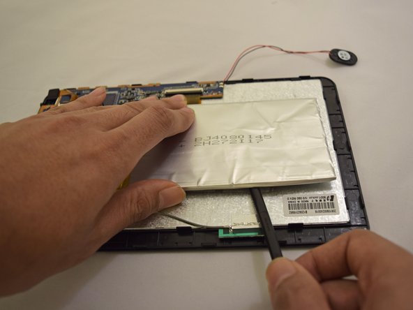

    2. 4Sight 9 Screen Replacement: crwdns2935265:05crwdnd2935265:01crwdnd2935265:02crwdne2935265:0 4Sight 9 Screen Replacement: crwdns2935265:05crwdnd2935265:02crwdnd2935265:02crwdne2935265:0
      • Insert plastic prying tool under upper-hand corner of battery and slide back and forth.
      • Once loosened, insert plastic prying tool under lower-hand corner and repeat sliding action.
      • Repeat previous actions until battery comes loose from device.

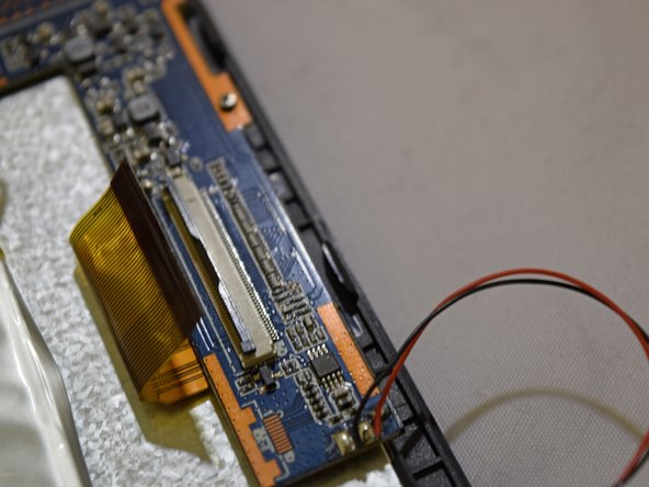

    1. 4Sight 9 Screen Replacement, Screen: crwdns2935265:06crwdnd2935265:01crwdnd2935265:02crwdne2935265:0 4Sight 9 Screen Replacement, Screen: crwdns2935265:06crwdnd2935265:02crwdnd2935265:02crwdne2935265:0
      • Grip the ribbon located at the far end of the circuit board with a plastic spudger tool.
      • Put pressure on the connector until the clasp comes undone.
      • Gently pull up on electrical ribbon until it disconnects from circuit board.
    2. 4Sight 9 Screen Replacement: crwdns2935265:07crwdnd2935265:01crwdnd2935265:02crwdne2935265:0 4Sight 9 Screen Replacement: crwdns2935265:07crwdnd2935265:02crwdnd2935265:02crwdne2935265:0
      • Remove the second electrical ribbon from the motherboard using the same technique used to remove first ribbon.

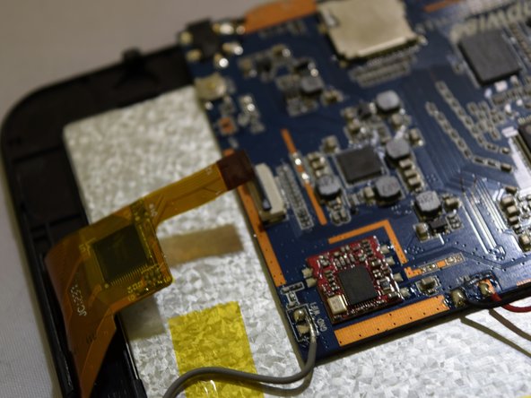

    4. 4Sight 9 Screen Replacement: crwdns2935265:09crwdnd2935265:01crwdnd2935265:02crwdne2935265:0 4Sight 9 Screen Replacement: crwdns2935265:09crwdnd2935265:02crwdnd2935265:02crwdne2935265:0
      • With fingers, grip the green Wi-Fi connector.
      • Gently pull up on connector to remove tape holding the connector in place.

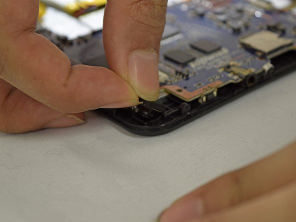

    5. 4Sight 9 Screen Replacement: crwdns2935265:010crwdnd2935265:01crwdnd2935265:02crwdne2935265:0 4Sight 9 Screen Replacement: crwdns2935265:010crwdnd2935265:02crwdnd2935265:02crwdne2935265:0
      • With the motherboard facing you, look to the bottom left corner, pull on the camera to completely free the motherboard.
    6. 4Sight 9 Screen Replacement: crwdns2935265:011crwdnd2935265:01crwdnd2935265:01crwdne2935265:0
      • Using your fingers, gently lift the motherboard and battery.
