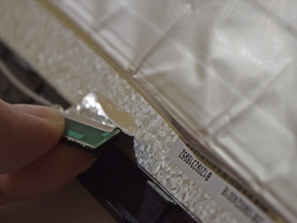

      • With fingers, grip the green Wi-Fi connector.
      • Gently pull up on connector to remove tape holding the connector in place.
    6. 4Sight 9 Motherboard Replacement: crwdns2935265:09crwdnd2935265:01crwdnd2935265:01crwdne2935265:0
      • Using your fingers, gently lift the motherboard.
