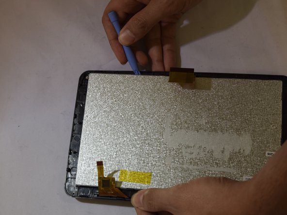

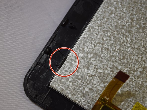

    1. 4Sight 9 Digitizer Replacement, Digitizer: crwdns2935265:010crwdnd2935265:01crwdnd2935265:03crwdne2935265:0 4Sight 9 Digitizer Replacement, Digitizer: crwdns2935265:010crwdnd2935265:02crwdnd2935265:03crwdne2935265:0 4Sight 9 Digitizer Replacement, Digitizer: crwdns2935265:010crwdnd2935265:03crwdnd2935265:03crwdne2935265:0
      • Insert plastic prying tool under screen and exert pressure, pulling upward.
      • Repeat this strep around each corner of screen until it pops off.
    2. 4Sight 9 Digitizer Replacement: crwdns2935265:011crwdnd2935265:01crwdnd2935265:01crwdne2935265:0
      • Place heating pad on glass frame in order to loosen adhesive for 3 to 5 minutes.
    3. 4Sight 9 Digitizer Replacement: crwdns2935265:012crwdnd2935265:01crwdnd2935265:01crwdne2935265:0
      • Use fingers to gently pull digitizer off of device.
