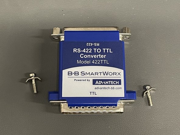

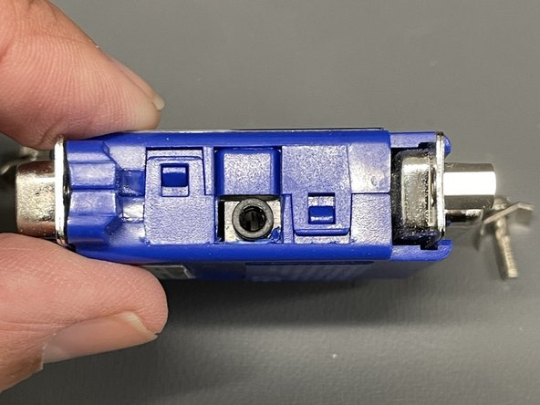

    • Remove side sticker (DC Power 12VDC)
    • Remove hardware (Screws and metal tabs)
    • Carefully lift 4 tabs (2 per side) to split unit into two halves.

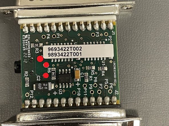

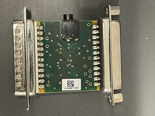

    • Remove the PCB from housing, examining where the headphone style power adapter attaches.
    • Desolder and remove the power adapter.

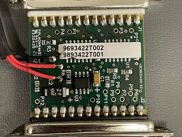

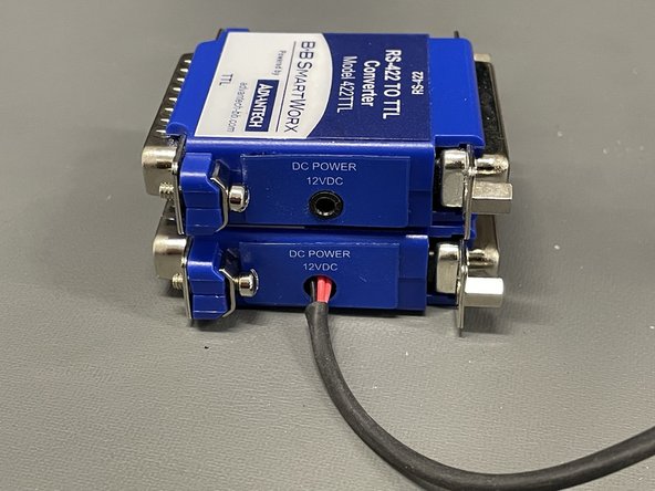

  3. 422TTL modification for Bench DC Power, Solder new power lines to the PCB.: crwdns2935265:03crwdnd2935265:01crwdnd2935265:03crwdne2935265:0 422TTL modification for Bench DC Power, Solder new power lines to the PCB.: crwdns2935265:03crwdnd2935265:02crwdnd2935265:03crwdne2935265:0 422TTL modification for Bench DC Power, Solder new power lines to the PCB.: crwdns2935265:03crwdnd2935265:03crwdnd2935265:03crwdne2935265:0
    • Positive (red) and negative (black) power lines should attach where the socket was removed.
