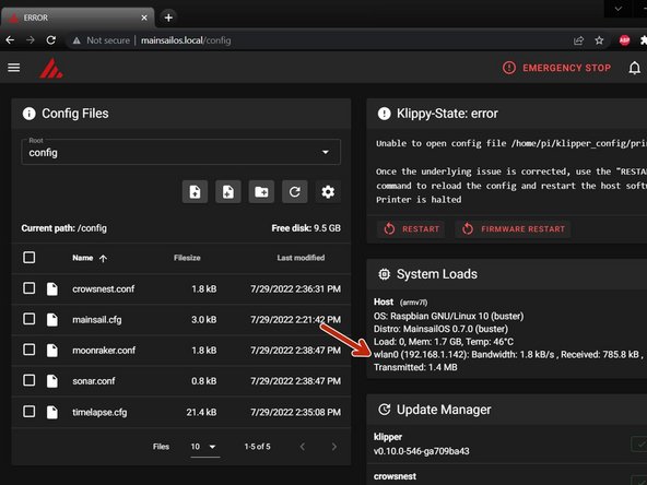

    • Open a web browser and go to
    • mainsail.local
    • On the machine tab you can see the IP address of your RPI next to "wlan0"
    • I use Remote Terminal, but using your favorite SSH client login to your RPI with the default credentials

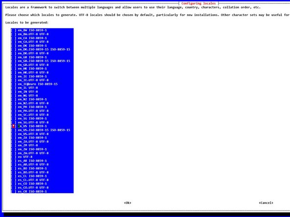

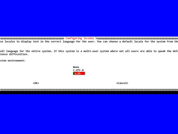

    • Set your locale
    • sudo raspi-config
    • Set your region preferences for L1-L4
    • Reboot your RPI when finished

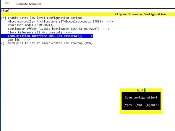

  5. 4. Installing Klipper on SKR3 EZ: crwdns2935265:06crwdnd2935265:01crwdnd2935265:01crwdne2935265:0
    • SSH into your pi and run
    • cd ~/klipper
    • make menuconfig
    • Set the following parameters
    • Enable extra low-level configuration options
    • Micro-controller Architecture (STMicroelectronics STM32) --->
    • Processor model (STM32H743) --->
    • Bootloader offset (128KiB bootloader (SKR SE BX v2.0)) --->
  6. 4. Installing Klipper on SKR3 EZ: crwdns2935265:07crwdnd2935265:01crwdnd2935265:03crwdne2935265:0 4. Installing Klipper on SKR3 EZ: crwdns2935265:07crwdnd2935265:02crwdnd2935265:03crwdne2935265:0 4. Installing Klipper on SKR3 EZ: crwdns2935265:07crwdnd2935265:03crwdnd2935265:03crwdne2935265:0
    • Continued
    • Clock Reference (25 MHz crystal) --->

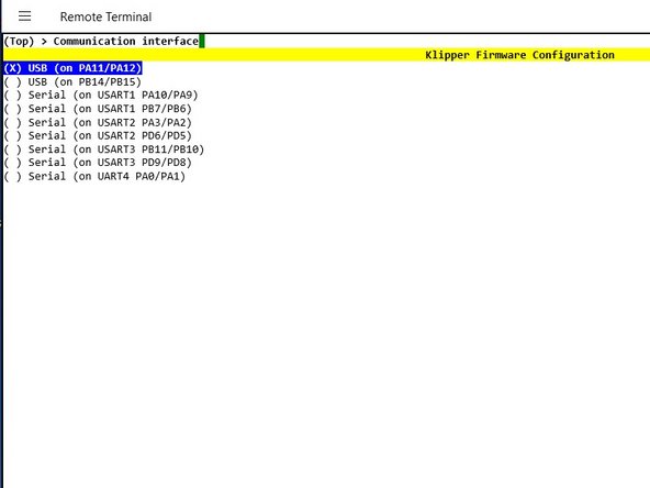

    • 3 wire cable connected from TFT to RPI GPIO
    • Communication interface (USART1 (on PA10/PA9)) --->
    • USB Cable
    • Communication interface (USB (on PA11/PA12)) --->
    • Press ESC key
    • Y to save configuration

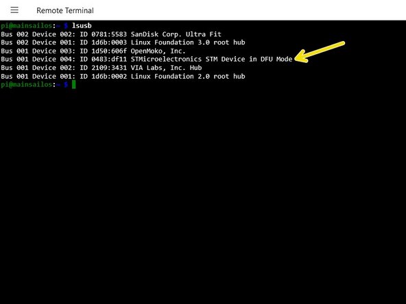

    • Press and hold the BOOT and RESET buttons.
    • Release the RESET button first, than release BOOT. This will put the board in DFU mode.
    • Get the boards ID number by running
    • lsusb
  8. 4. Installing Klipper on SKR3 EZ, For UART and USB Connected Boards: crwdns2935265:09crwdnd2935265:01crwdnd2935265:02crwdne2935265:0 4. Installing Klipper on SKR3 EZ, For UART and USB Connected Boards: crwdns2935265:09crwdnd2935265:02crwdnd2935265:02crwdne2935265:0

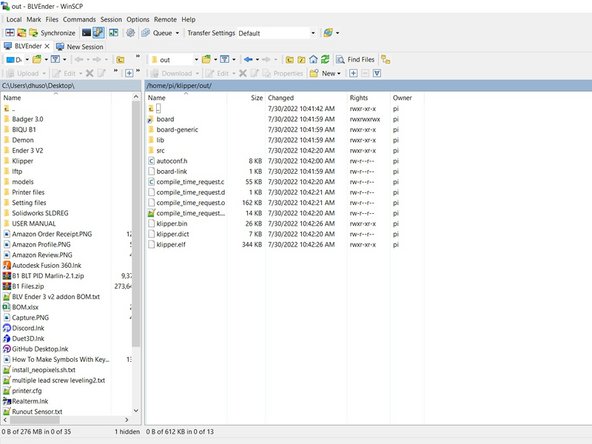

    • Open WINSCP
    • Navigate to /klipper/out/
    • Copy klipper.bin to your PC and rename it to firmware.bin
    • Copy firmware.bin to a SD. Make sure the SD card is formatted to FAT32.

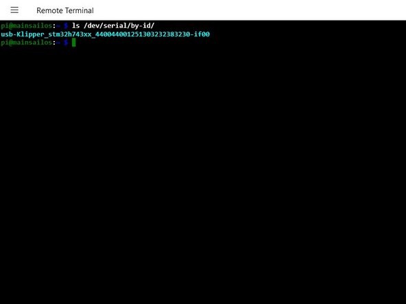

    • You need to get the boards ID. Run
    • ls /dev/serial/by-id/
    • Reboot the RPI
