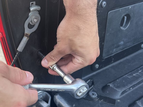

    • Identify the 4 bolts on the inside of the tailgate.
    • Use a 10mm socket to remove the four bolts that secure the headlight housing to the chassis bracket.
    • All the bolts are identical. Therefore, there is no need to worry about inserting any of the wrong bolts upon reassemble.

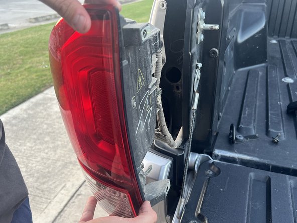

    • Grasp the top and bottom of your taillight.
    • Ensure you are pulling directly back. If this is your first time taking off your taillight it will be tight and require some force to pull off.
    • If this is your first time taking off your taillight it will be tight and require some force to pull off.

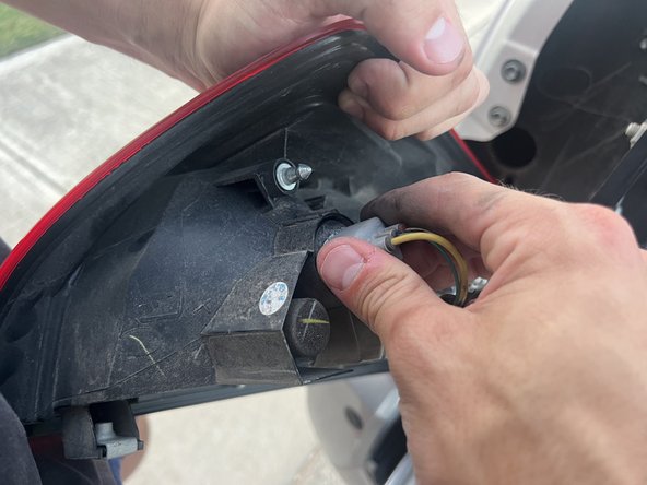

    • The lights are housed in 2 separate sockets. Decide which one needs to be replaced. The disassembly process is the same for both lights.
    • Grasp the gray portion of the light and twist clockwise.
    • The Socket will loosen and disengage still housing the bulb.
  5. 3rd Generation Toyota Tacoma Tail Light Replacement: crwdns2935265:05crwdnd2935265:01crwdnd2935265:02crwdne2935265:0 3rd Generation Toyota Tacoma Tail Light Replacement: crwdns2935265:05crwdnd2935265:02crwdnd2935265:02crwdne2935265:0
    • Grasp the bulb and pull. The bulb will disengage from the socket with minimal effort.
    • Properly discard the bulb opting for the most environmentally friendly option.
    • Replace the bulb by pushing the new one straight into the bulb's housing using minimal force.
    • The bulbs are made of glass so if dropped they will shatter and be a potential hazard discard with caution.

    • Grasp the top and bottom of your entire taillight assembly.
    • Insert the assembly by pushing straight forward in a firm fashion.
    • The grey push tabs are made of plastic therefore they can be fragile. Opt for less force as the tabs could be damaged.

    • Use a 10mm socket to tighten the 4 bolts to secure the headlight housing to the chassis bracket.
    • Ensure you do not over-tighten the 10mm bolts as it will increase the difficulty of future repairs.
