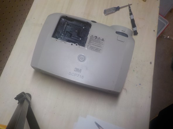

  1. 3M SCP176 Projector Lamp Replacement, Remove the lamp: crwdns2935265:01crwdnd2935265:01crwdnd2935265:03crwdne2935265:0 3M SCP176 Projector Lamp Replacement, Remove the lamp: crwdns2935265:01crwdnd2935265:02crwdnd2935265:03crwdne2935265:0 3M SCP176 Projector Lamp Replacement, Remove the lamp: crwdns2935265:01crwdnd2935265:03crwdnd2935265:03crwdne2935265:0
    • Remove the 2 screws holding the lamp cover on. Then remove the cover. There are 2 screws on the lamp with arrows pointing towards them. You can loosen those screws and lift the lamp straight out of the projector.
  2. 3M SCP176 Projector Lamp Replacement, Lamp Info: crwdns2935265:02crwdnd2935265:01crwdnd2935265:01crwdne2935265:0
    • The lamp is an Osram P-VIP 180-230W/10 E20.6, according to markings on the lamp.
    • Fore more info, please visit the teardown of this projector model.
  3. 3M SCP176 Projector Lamp Replacement, Install the lamp: crwdns2935265:03crwdnd2935265:01crwdnd2935265:03crwdne2935265:0 3M SCP176 Projector Lamp Replacement, Install the lamp: crwdns2935265:03crwdnd2935265:02crwdnd2935265:03crwdne2935265:0 3M SCP176 Projector Lamp Replacement, Install the lamp: crwdns2935265:03crwdnd2935265:03crwdnd2935265:03crwdne2935265:0
    • Push the lamp down into the projector. Then tighten the 2 screws on the lamp and reinstall the cover the same way you removed it.
