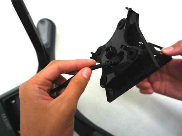

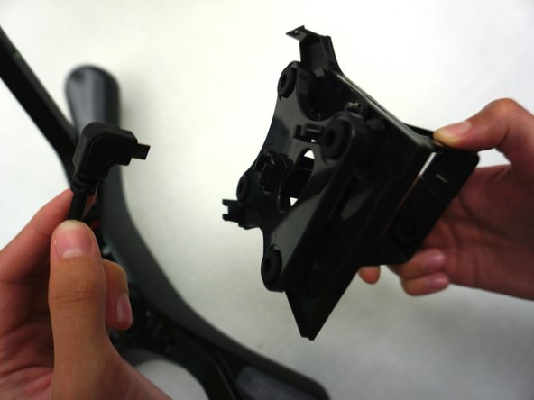

  8. 3DR Solo Gimbal Replacement: crwdns2935265:09crwdnd2935265:01crwdnd2935265:03crwdne2935265:0 3DR Solo Gimbal Replacement: crwdns2935265:09crwdnd2935265:02crwdnd2935265:03crwdne2935265:0 3DR Solo Gimbal Replacement: crwdns2935265:09crwdnd2935265:03crwdnd2935265:03crwdne2935265:0
    • Once the gimbal and panel is loose enough to pull off with your hand, gently remove both the panel and the gimbal from the device.
    • When doing this, be sure to leave the micro SD cable inside the device.
