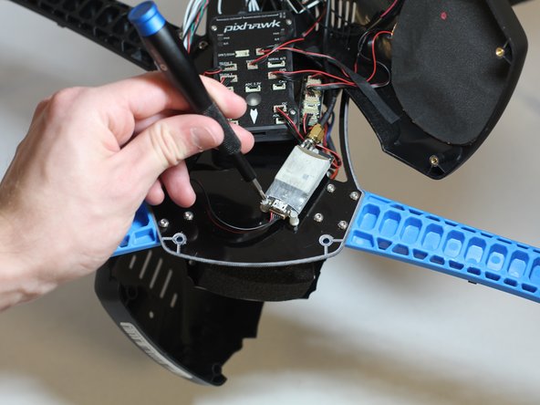

  11. 3DR Iris Plus Quadcopter RX Transmitter Replacement, RX Transmitter: crwdns2935265:011crwdnd2935265:01crwdnd2935265:01crwdne2935265:0
    • Using your fingers, gently twist and disconnect the gold part on the cable attached to the RX Transmitter.
  12. 3DR Iris Plus Quadcopter RX Transmitter Replacement: crwdns2935265:012crwdnd2935265:01crwdnd2935265:01crwdne2935265:0
    • Lightly pull the wire to disconnect it from the RX Transmitter.
  13. 3DR Iris Plus Quadcopter RX Transmitter Replacement: crwdns2935265:013crwdnd2935265:01crwdnd2935265:02crwdne2935265:0 3DR Iris Plus Quadcopter RX Transmitter Replacement: crwdns2935265:013crwdnd2935265:02crwdnd2935265:02crwdne2935265:0
    • Using the Phillips #1 screwdriver, remove the three 5mm screws that attach the RX transmitter to the drone assembly.
    • Lift to remove the RX Transmitter.
