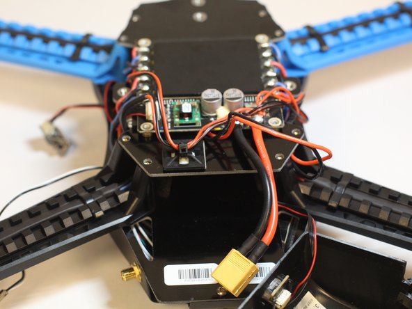

  9. 3DR Iris Plus Quadcopter Battery Connector Replacement, Battery Connector: crwdns2935265:09crwdnd2935265:01crwdnd2935265:02crwdne2935265:0 3DR Iris Plus Quadcopter Battery Connector Replacement, Battery Connector: crwdns2935265:09crwdnd2935265:02crwdnd2935265:02crwdne2935265:0
    • Identify the power line by locating the black and red wire pair with the largest gauge (wire thickness) extending from the board with a large black heat sink.
    • The power line also has a female XT60 connector attached on the opposite end.
  10. 3DR Iris Plus Quadcopter Battery Connector Replacement: crwdns2935265:010crwdnd2935265:01crwdnd2935265:01crwdne2935265:0
    • Cut and remove the damaged portion of the power cable with wire strippers or end cutters.
    • Take a new XT60 male connector with pre-attached wires (at least 14 AWG) and solder it to what is left of the connected power line.
    • You can purchase the XT60 male connectors through Amazon or most hobbyist drone shops.
    • Make sure that once the wire has been reassembled to electrically isolate any exposed wire using electrical tape or heat shrink.
