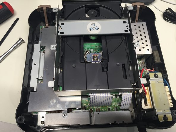

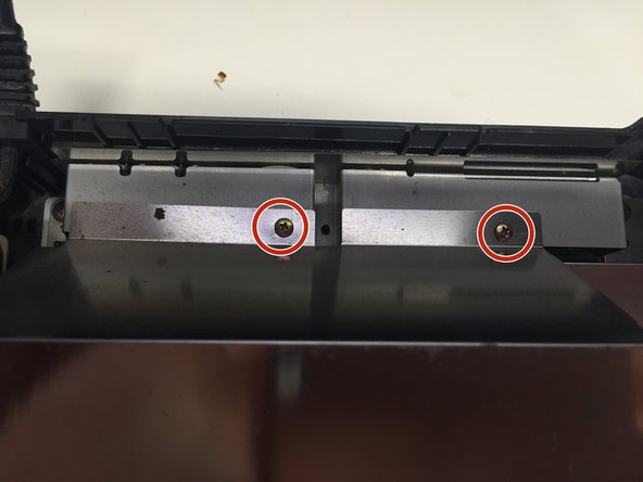

    • Remove the 2 #1 Phillips Screws from the back of the Disc Drive Shield.
    • Using a Spudger, carefully pry up the four metal tabs to remove the disc drive cover.
    • Remove the 4 #2 Phillips Screws.
    • Remove the disc drive shield, and the two bars you just unscrewed.

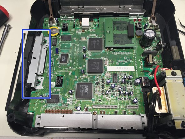

    • Remove the 11 #1 Phillips Screws connecting the metal shield to the motherboard.
    • Remove the metal shield.
    • Remove the metal cover from the expansion port.

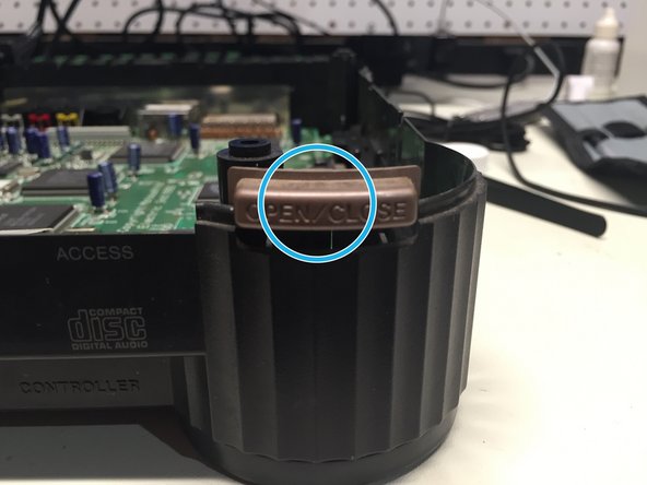

    • Remove the plastic cover, power and eject buttons found at the front end of the unit.

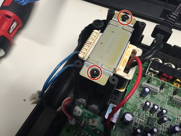

    • Unplug the power and fan cables from the motherboard.
    • Remove the 2 #2 Phillips Screws holding the power supply to the case.
    • The electric screwdriver comes in handy loosening the PSU screws on the FZ-1.
    • Remove the power supply and fan from the case.
