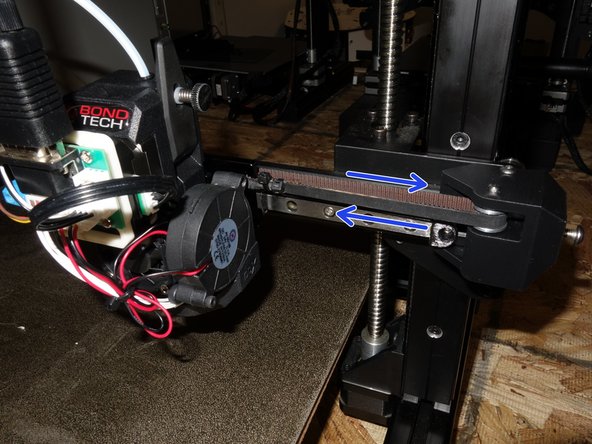

    • After moving Z to 250mm above the bed and removing filament, Power Off, Power Cables UNPLUGGED!
    • Remove printhead, DB15 cable, and control box and set aside.
    • You will need access to the back of the machine as well as the front. Give yourself enough room to rotate the machine if not work all they way around. Another tip is to place a piece of cardboard on the build surface to use a place to work.
    • If you have access to compressed air, blow the machine off. Use this time to clean the machine and give yourself good lighting to look over all the components thoroughly.
    • Using a 8mm open end wrench, loosen the bottom inner wheel eccentric locknut. Back it off a few turns.
    • Using a 7mm closed end wrench hold the nylock nut on the front of the X/Z bracket and loosen the eccentric wheel shaft with the M2.5 hex.
    • Fully remove both lower inner wheels. They will not be used.
    • 3 points is superior to 4 in this case.

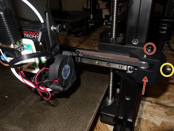

    • The X Axis assembly is attached to the X/Z trolleys with 4 M4 cap screws and T nuts.
    • Unplug the X End Stop then the X Motor (this can be done before or after X Axis removal depending on your access)
    • Remove the assembly by loosening the cap screws from the back of the machine. The T nuts just need to align parallel to the slot.
    • Hold on to the X Axis assembly with one hand. If not, it will fall onto the bed.
    • Be sure the X Motor is unplugged

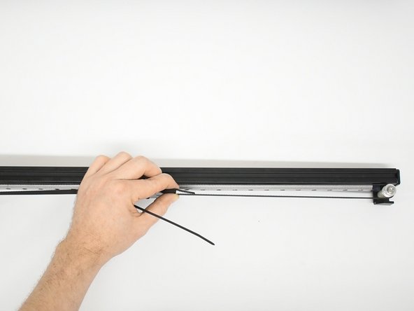

    • Route one end of the belt through the front of the belt slot on the X Carriage Plate and fold over about ½”. Using a cable tie, secure that end in place, making sure the teeth on the belt mesh together to hold tight.
    • Run the belt around the opposite side pulley and back to the open slot repeating the process, this time pulling the belt tight with your hands or needle nose pliers before securing with a cable tie.

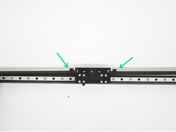

    • Add a second cable tie to both sides next to the others.
    • Move the X Carriage Plate back and forth. It should be nice and smooth.
    • The belt should spring back when you push on it now. It can be final adjusted when the new X Axis assembly is installed on the machine.
