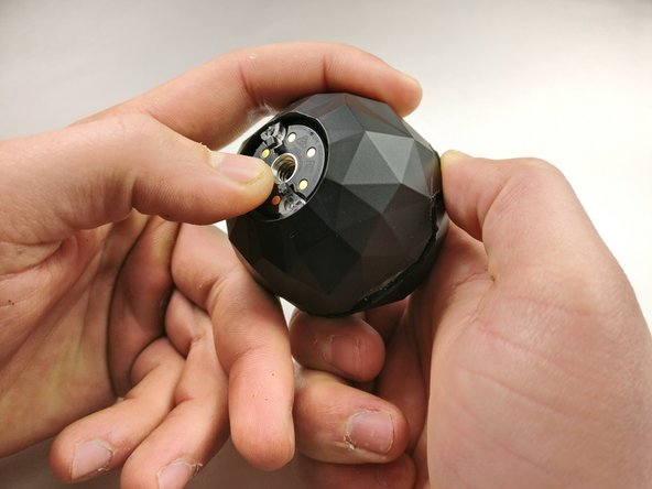

  3. 360fly 4K Battery Replacement: crwdns2935265:03crwdnd2935265:01crwdnd2935265:02crwdne2935265:0 360fly 4K Battery Replacement: crwdns2935265:03crwdnd2935265:02crwdnd2935265:02crwdne2935265:0
    • Gently pry the plastic ring from around the charging plate with the metal spudger.
    • Remove the outside shell by pressing against the center of the charging plate and pulling the bottom shell away from the top shell.

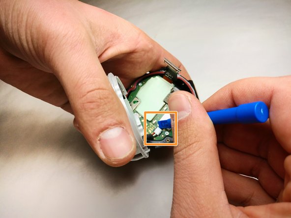

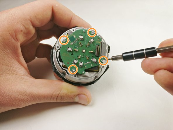

  5. 360fly 4K Battery Replacement: crwdns2935265:05crwdnd2935265:01crwdnd2935265:02crwdne2935265:0 360fly 4K Battery Replacement: crwdns2935265:05crwdnd2935265:02crwdnd2935265:02crwdne2935265:0
    • Gently pry the plug off the port on the circuit board with a plastic opening tool.
    • Remove the four 2 mm screws using a T4 screwdriver.
    • Remove the circuit board from the device.

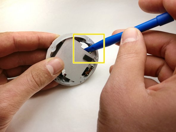

  6. 360fly 4K Battery Replacement: crwdns2935265:06crwdnd2935265:01crwdnd2935265:03crwdne2935265:0 360fly 4K Battery Replacement: crwdns2935265:06crwdnd2935265:02crwdnd2935265:03crwdne2935265:0 360fly 4K Battery Replacement: crwdns2935265:06crwdnd2935265:03crwdnd2935265:03crwdne2935265:0
    • Remove the five 4 mm screws around the battery assembly with a T4 screwdriver.
    • Lift the battery assembly and gently pry the plug out of its port on the board below with a plastic opening tool.
    • Press the battery from the back of the battery assembly to remove it with a plastic opening tool until the glue releases the battery.
    • Potential for device damage: Do not puncture or bend the battery. Use a small amount of heat to assist in softening the adhesive if necessary.
