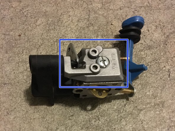

    • Pull the air filter from the housing.
    • Remove the air filter housing using a 8 mm socket.

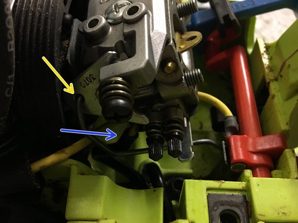

    • Disconnect the two fuel lines from the carburetor using a narrow, flat-head screw driver.
    • Disconnect the throttle linkage from the carburetor.
    • Lift the choke linkage out of the housing, and then pull the carburetor from the housing.

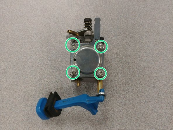

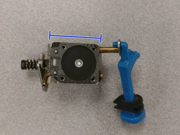

    • Remove the four screws holding the diaphragm cover plate, and then remove the plate.
    • Remove the diaphragm and its seal from the carburetor.

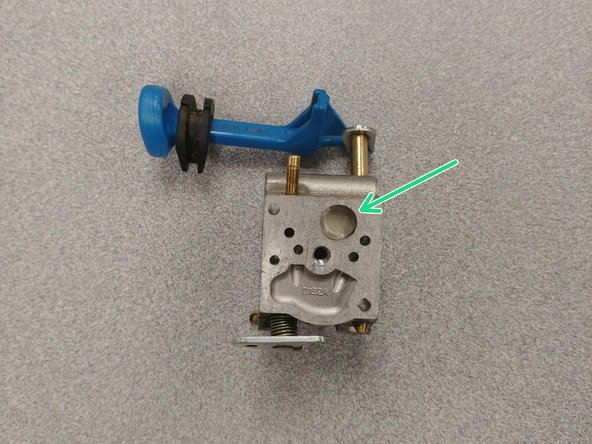

    • Remove the screw holding the fuel pump cover in place using the chainsaw T-wrench.
    • Remove the fuel pump gasket and valve.
    • Remove the fuel filter screen.

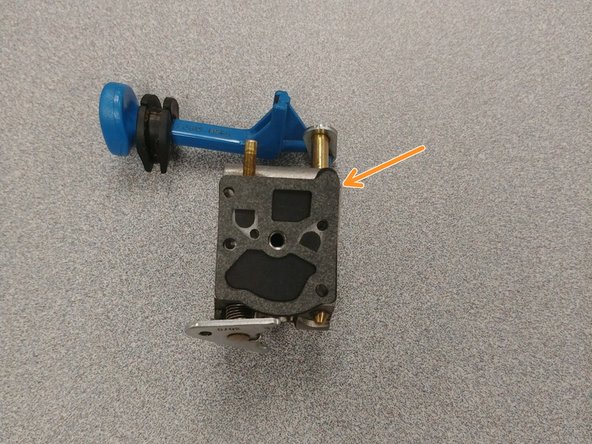

    • Align a new fuel pump valve and gasket with the carburetor.
    • Reattach the fuel pump top cover using the chainsaw T-wrench.

    • Install a new float set and needle valve.
    • Install the float set and needle valve retaining screw.
    • Place a new diaphragm and seal in position.
    • Replace the diaphragm cover and the four retaining screws.

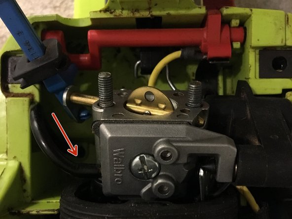

    • Attach the fuel lines and the throttle linkage to the carburetor.
    • The line coming directly from the fuel tank connects to the fuel pump inlet.
    • The line coming from the external primer bulb goes to the diaphragm inlet.
    • Reinstall the throttle linkage.
