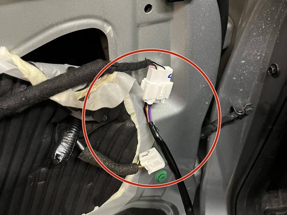

    • Tear a small gap in the sound insulation cotton by hand.
    • Find the interface between the side mirror and the power supply in the car, then disconnect it.

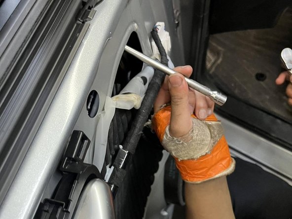

    • Using a hex wrench screwdriver, firmly loosen the screws holding the side view mirror inside the door.
    • Remove the side mirror.
    • Be careful not to let the mirror move into the door gap after loosening the screw.
