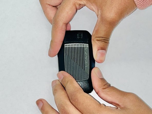

    • Flip the fob so the backside is facing up.
  2. 2021 Toyota Venza Key Fob Battery Replacement: crwdns2935265:02crwdnd2935265:01crwdnd2935265:03crwdne2935265:0 2021 Toyota Venza Key Fob Battery Replacement: crwdns2935265:02crwdnd2935265:02crwdnd2935265:03crwdne2935265:0 2021 Toyota Venza Key Fob Battery Replacement: crwdns2935265:02crwdnd2935265:03crwdnd2935265:03crwdne2935265:0
    • Slide the lock to the right.
    • Pull the key out from the top of fob case.

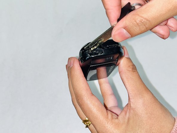

  3. 2021 Toyota Venza Key Fob Battery Replacement: crwdns2935265:03crwdnd2935265:01crwdnd2935265:02crwdne2935265:0 2021 Toyota Venza Key Fob Battery Replacement: crwdns2935265:03crwdnd2935265:02crwdnd2935265:02crwdne2935265:0
    • Insert the tip of the key or a spudger into the space where the key was and begin to pry the two parts of the fob apart.

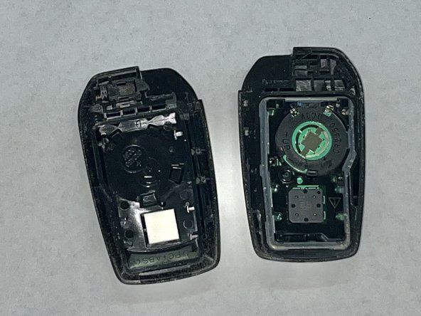

  4. 2021 Toyota Venza Key Fob Battery Replacement: crwdns2935265:04crwdnd2935265:01crwdnd2935265:03crwdne2935265:0 2021 Toyota Venza Key Fob Battery Replacement: crwdns2935265:04crwdnd2935265:02crwdnd2935265:03crwdne2935265:0 2021 Toyota Venza Key Fob Battery Replacement: crwdns2935265:04crwdnd2935265:03crwdnd2935265:03crwdne2935265:0
    • If that doesn't work twist the key slightly and open up the plastic case.

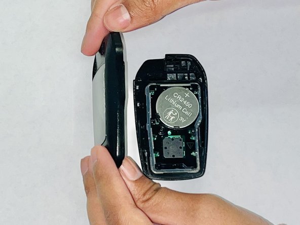

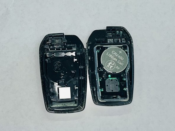

  5. 2021 Toyota Venza Key Fob Battery Replacement: crwdns2935265:05crwdnd2935265:01crwdnd2935265:02crwdne2935265:0 2021 Toyota Venza Key Fob Battery Replacement: crwdns2935265:05crwdnd2935265:02crwdnd2935265:02crwdne2935265:0
    • Gently remove the old battery.

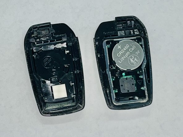

  6. 2021 Toyota Venza Key Fob Battery Replacement: crwdns2935265:06crwdnd2935265:01crwdnd2935265:02crwdne2935265:0 2021 Toyota Venza Key Fob Battery Replacement: crwdns2935265:06crwdnd2935265:02crwdnd2935265:02crwdne2935265:0
    • Insert a new CR2450 lithium cell battery.

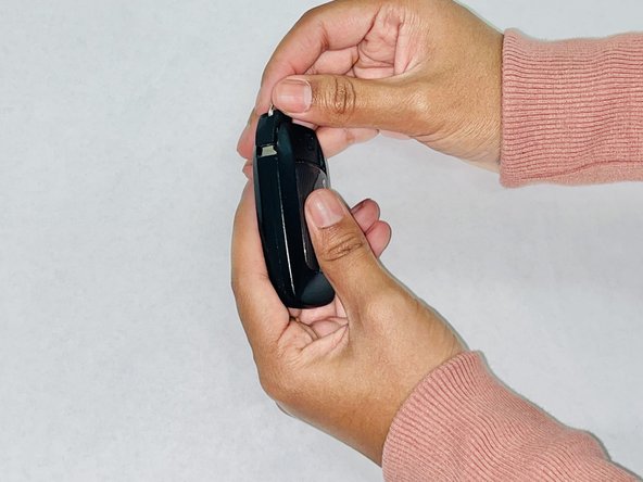

  7. 2021 Toyota Venza Key Fob Battery Replacement: crwdns2935265:07crwdnd2935265:01crwdnd2935265:02crwdne2935265:0 2021 Toyota Venza Key Fob Battery Replacement: crwdns2935265:07crwdnd2935265:02crwdnd2935265:02crwdne2935265:0
    • Replace the back case.
    • Press the two halves together and snap it shut.

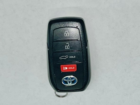

  8. 2021 Toyota Venza Key Fob Battery Replacement: crwdns2935265:08crwdnd2935265:01crwdnd2935265:03crwdne2935265:0 2021 Toyota Venza Key Fob Battery Replacement: crwdns2935265:08crwdnd2935265:02crwdnd2935265:03crwdne2935265:0 2021 Toyota Venza Key Fob Battery Replacement: crwdns2935265:08crwdnd2935265:03crwdnd2935265:03crwdne2935265:0
    • Insert the key back into the case.
    • You're done!
Press on the controller, and if a red light is shown when pressed, battery replacement is a success.
To double-check, go to your Toyota Venza and press the unlock or lock button; if the car responds, the battery works perfectly fine.
