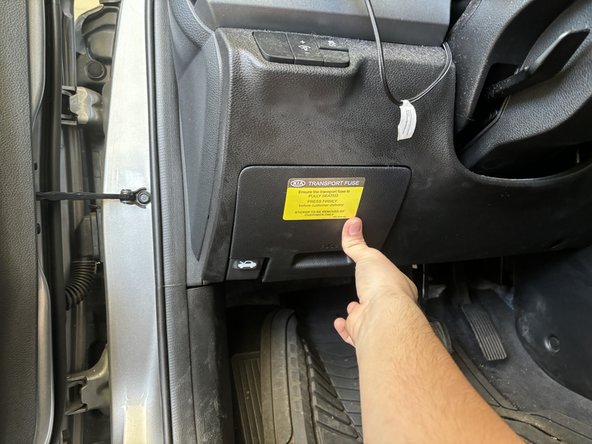

    • Assure that the vehicle is completely off, you can tell that this is the case if the small light above the words on the button is off, and the engine should be silent.
  3. 2021 Kia Rio Driver Side Fuse Replacement: crwdns2935265:03crwdnd2935265:01crwdnd2935265:03crwdne2935265:0 2021 Kia Rio Driver Side Fuse Replacement: crwdns2935265:03crwdnd2935265:02crwdnd2935265:03crwdne2935265:0 2021 Kia Rio Driver Side Fuse Replacement: crwdns2935265:03crwdnd2935265:03crwdnd2935265:03crwdne2935265:0

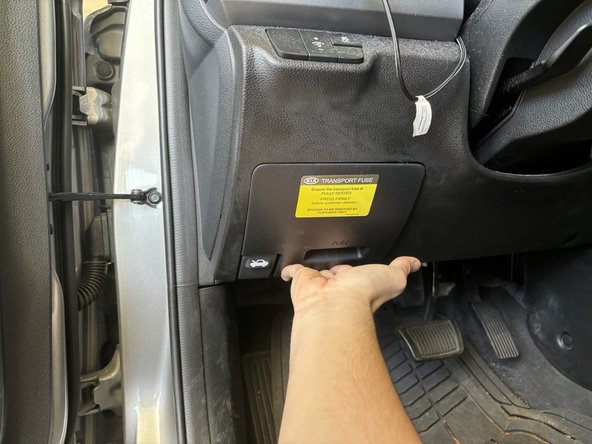

    • Grip the handle on the bottom side of the fuse box cover and pull it up and away to remove the cover.
  4. 2021 Kia Rio Driver Side Fuse Replacement: crwdns2935265:04crwdnd2935265:01crwdnd2935265:03crwdne2935265:0 2021 Kia Rio Driver Side Fuse Replacement: crwdns2935265:04crwdnd2935265:02crwdnd2935265:03crwdne2935265:0 2021 Kia Rio Driver Side Fuse Replacement: crwdns2935265:04crwdnd2935265:03crwdnd2935265:03crwdne2935265:0

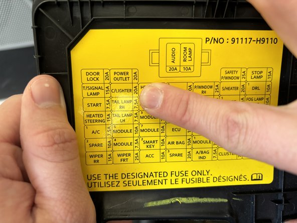

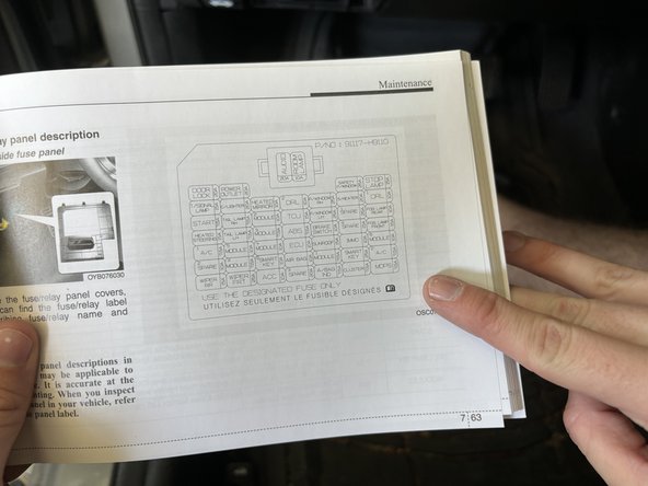

    • Locate the desired fuse using the owners manual, on page 7:63.
    • The diagram to locate fuses is also on the backside of the fuse box cover.
