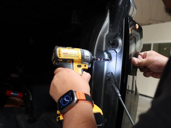

    • Open the tailgate.
    • Remove the top and bottom T15 screws from each side of the tail lights.
    • Gently remove the tail lights by pulling outward.

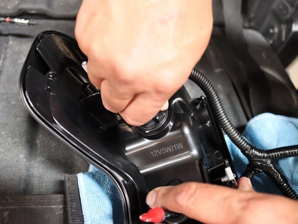

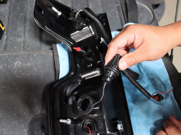

    • Unplug the sockets and remove the reverse light bulb from the tail light.

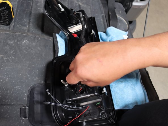

  3. 2021 Chevrolet Silverado Tail Light Replacement: crwdns2935265:03crwdnd2935265:01crwdnd2935265:03crwdne2935265:0 2021 Chevrolet Silverado Tail Light Replacement: crwdns2935265:03crwdnd2935265:02crwdnd2935265:03crwdne2935265:0 2021 Chevrolet Silverado Tail Light Replacement: crwdns2935265:03crwdnd2935265:03crwdnd2935265:03crwdne2935265:0
    • Plug the brake lights connector.
    • Twist and secure the socket tightly.
    • Plug in the turn signal bulb connector. Twist and secure tightly.

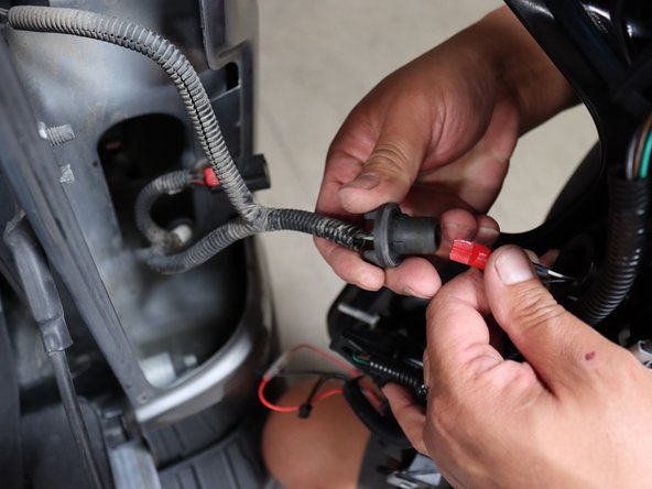

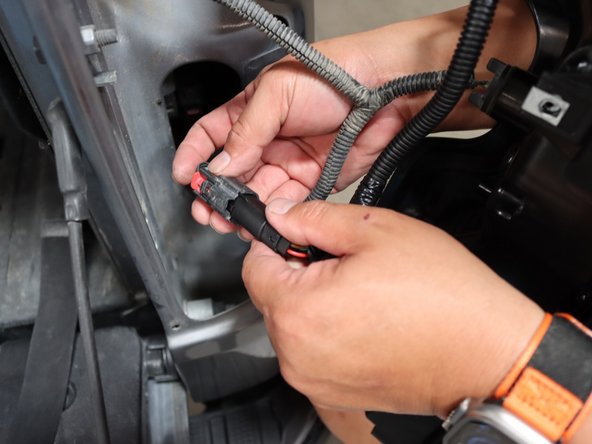

  4. 2021 Chevrolet Silverado Tail Light Replacement: crwdns2935265:04crwdnd2935265:01crwdnd2935265:03crwdne2935265:0 2021 Chevrolet Silverado Tail Light Replacement: crwdns2935265:04crwdnd2935265:02crwdnd2935265:03crwdne2935265:0 2021 Chevrolet Silverado Tail Light Replacement: crwdns2935265:04crwdnd2935265:03crwdnd2935265:03crwdne2935265:0
    • Plug in the parking lights connector. Twist and secure the socket tightly.
    • Plug in the TURN SIGNALS connector. Please follow the same steps for the other side of the tail lights.
    • Make sure all the connections are plugged and tight. Also ensure that the caps are sealed.

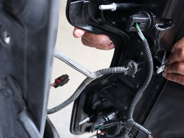

  5. 2021 Chevrolet Silverado Tail Light Replacement: crwdns2935265:05crwdnd2935265:01crwdnd2935265:02crwdne2935265:0 2021 Chevrolet Silverado Tail Light Replacement: crwdns2935265:05crwdnd2935265:02crwdnd2935265:02crwdne2935265:0
    • First, remove the reverse light bulb from the vehicle.
    • Then, connect the socket to the reverse light connector from the new tail light.

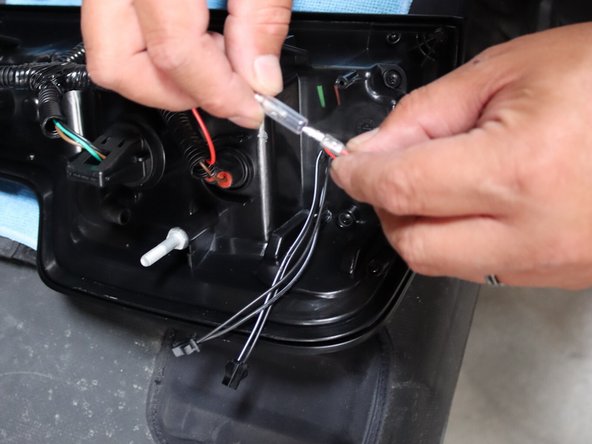

  6. 2021 Chevrolet Silverado Tail Light Replacement: crwdns2935265:06crwdnd2935265:01crwdnd2935265:03crwdne2935265:0 2021 Chevrolet Silverado Tail Light Replacement: crwdns2935265:06crwdnd2935265:02crwdnd2935265:03crwdne2935265:0 2021 Chevrolet Silverado Tail Light Replacement: crwdns2935265:06crwdnd2935265:03crwdnd2935265:03crwdne2935265:0
    • Lastly, plug the vehicle’s tail light socket to new tail light connector.
  7. 2021 Chevrolet Silverado Tail Light Replacement: crwdns2935265:07crwdnd2935265:01crwdnd2935265:03crwdne2935265:0 2021 Chevrolet Silverado Tail Light Replacement: crwdns2935265:07crwdnd2935265:02crwdnd2935265:03crwdne2935265:0 2021 Chevrolet Silverado Tail Light Replacement: crwdns2935265:07crwdnd2935265:03crwdnd2935265:03crwdne2935265:0
    • Gently push the tail light into the mounting position and use T15 screwdriver to tighten the top and bottom screws.
    • Repeat the same process for the other side of the tail light.
