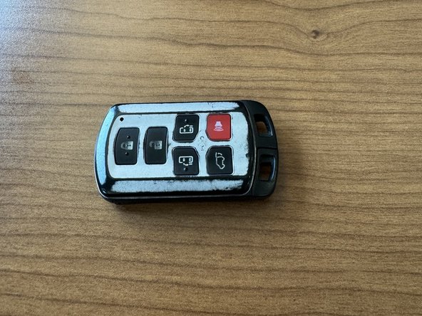

    • Position the battery on its side where the "Push" button is.
    • Click down on the "Push" button.
    • Pull out the physical key at the top of the fob on the same side as the "Push" button is located.

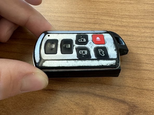

  2. 2020 Toyota Sienna Key Fob Battery Replacement: crwdns2935265:02crwdnd2935265:01crwdnd2935265:03crwdne2935265:0 2020 Toyota Sienna Key Fob Battery Replacement: crwdns2935265:02crwdnd2935265:02crwdnd2935265:03crwdne2935265:0 2020 Toyota Sienna Key Fob Battery Replacement: crwdns2935265:02crwdnd2935265:03crwdnd2935265:03crwdne2935265:0
    • Place the tip of a spudger in the slotted area and twist to pry the fob open.
    • Separate the two sides of the fob carefully.

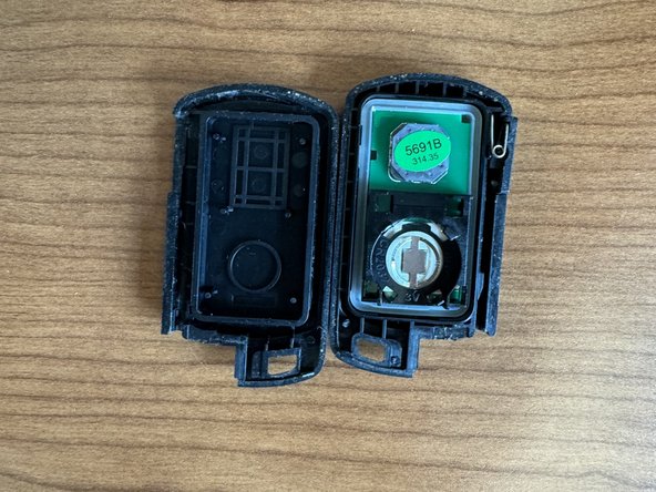

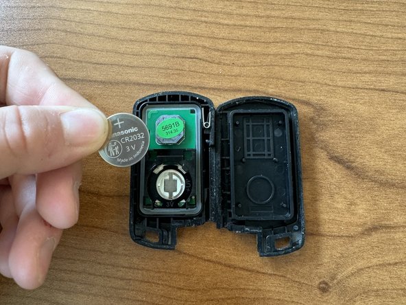

  3. 2020 Toyota Sienna Key Fob Battery Replacement: crwdns2935265:03crwdnd2935265:01crwdnd2935265:03crwdne2935265:0 2020 Toyota Sienna Key Fob Battery Replacement: crwdns2935265:03crwdnd2935265:02crwdnd2935265:03crwdne2935265:0 2020 Toyota Sienna Key Fob Battery Replacement: crwdns2935265:03crwdnd2935265:03crwdnd2935265:03crwdne2935265:0
    • Lay out the two sides of the fob with the interior of the fob facing you.
    • Remove the battery from the key fob.
    • Carefully insert the new battery in the battery placeholder.
