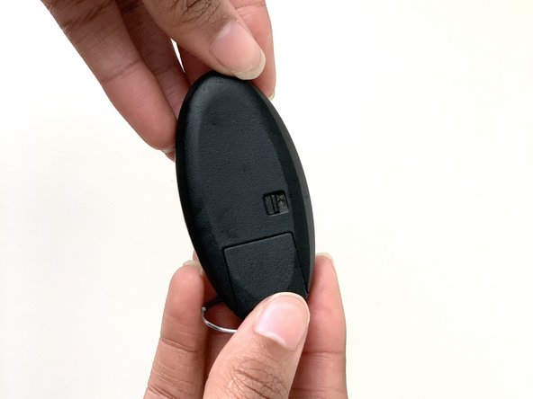

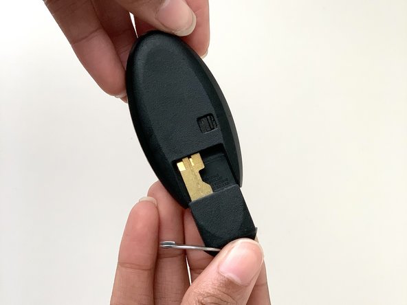

    • Remove the key by pulling the lever on the back of the keyless remote.

    • Use a prying tool to pry the back cover away from the rest of the remote.
