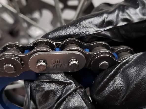

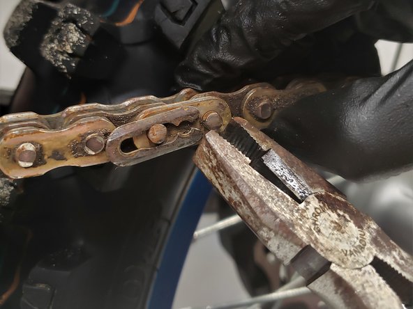

    • Locate the master-link on the chain.
    • The master-link has a safety clip on it in the shape of a C.

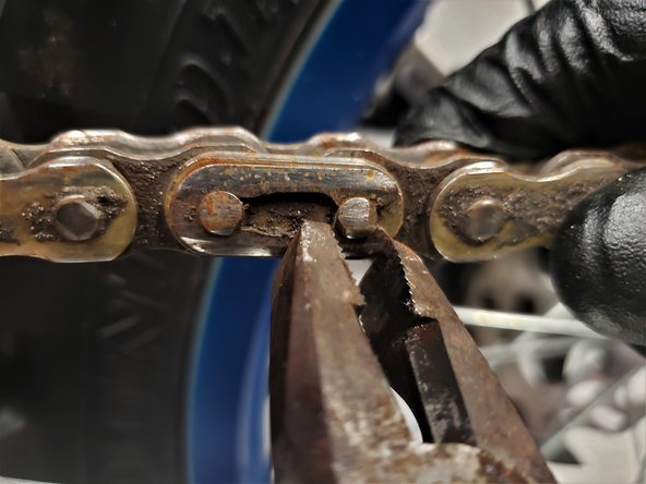

  4. 2018 Yamaha YZ 250f Chain Replacement: crwdns2935265:04crwdnd2935265:01crwdnd2935265:03crwdne2935265:0 2018 Yamaha YZ 250f Chain Replacement: crwdns2935265:04crwdnd2935265:02crwdnd2935265:03crwdne2935265:0 2018 Yamaha YZ 250f Chain Replacement: crwdns2935265:04crwdnd2935265:03crwdnd2935265:03crwdne2935265:0
    • Use pliers to remove the safety clip from the master-link.
    • If the clip is worn it may break.

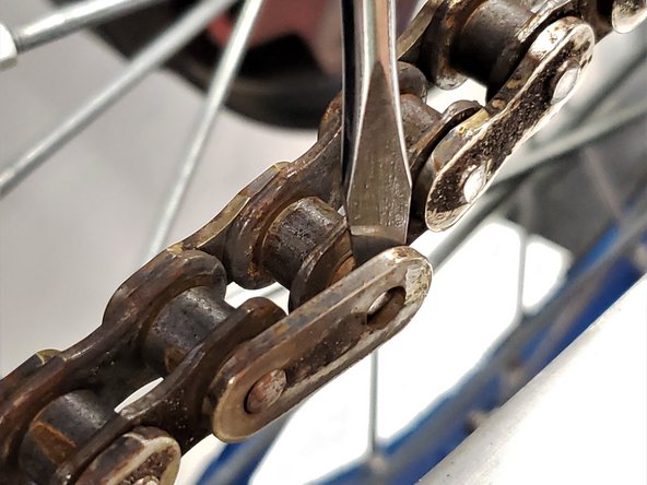

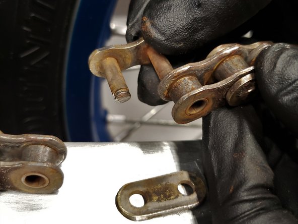

    • Use a mallet and flathead screw driver to pry off the master-link side plate.
    • Remove the master link.

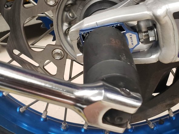

    • Use a 30mm socket and breaker bar to loosen the rear axle nut.

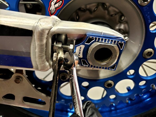

    • Use a 10mm and 12mm wrench to loosen the axle blocks.
  10. 2018 Yamaha YZ 250f Chain Replacement: crwdns2935265:010crwdnd2935265:01crwdnd2935265:01crwdne2935265:0
    • Slide the axle blocks so that it is on the center mark of the swing-arm.
    • Centering the axle blocks will allow for the maximum life of the chain.

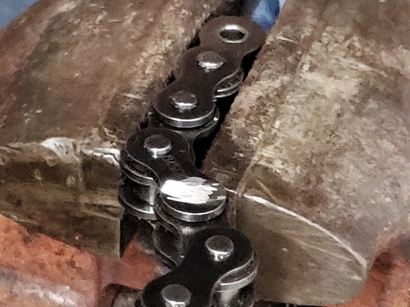

    • Take the chain off of the bike and use a grinder or chain-break to remove the extra unwanted links.
    • Before cutting, make sure that you have marked the proper amount of links to be removed. Once the chain is cut this cannot be undone.

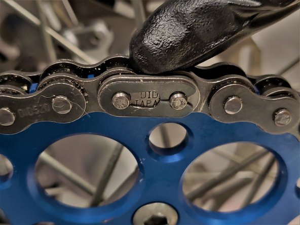

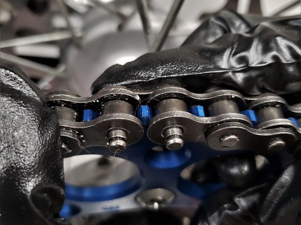

    • Place the chain back on the dirt bike and roll it until both open ends are on top of the rear sprocket.
    • Insert master-link into the chain from the inside out.
    • Install side plate to master-link.
  15. 2018 Yamaha YZ 250f Chain Replacement: crwdns2935265:015crwdnd2935265:01crwdnd2935265:02crwdne2935265:0 2018 Yamaha YZ 250f Chain Replacement: crwdns2935265:015crwdnd2935265:02crwdnd2935265:02crwdne2935265:0
    • Use pliers to install the safety clip onto the master-link.
    • The open end of the safety clip should be opposite the direction of wheel rotation when moving forward.
    • If safety clip is not installed properly it may cause the chain to fall off while operating.

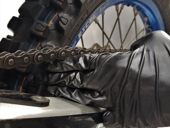

    • Once axle blocks are in the correct position, tighten the rear axle using the 30mm socket and breaker bar.
    • Use the 10mm and 12mm wrench to tighten the axle blocks.
    • Ensure there is a small amount of slack in the chain. The 3 finger method displayed is a good rule of thumb when determining chain slack.
    • Check to make sure wheel spins freely with new chain installed.
