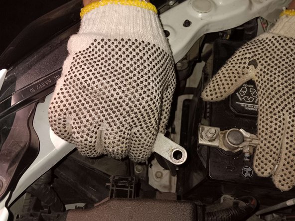

    • Open the hood and locate your battery.
  2. 2018 Toyota Corolla LE Battery Replacement: crwdns2935265:02crwdnd2935265:01crwdnd2935265:01crwdne2935265:0
    • Remove the screws from the brace securing the battery.

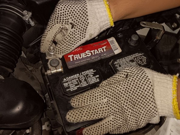

  3. 2018 Toyota Corolla LE Battery Replacement: crwdns2935265:03crwdnd2935265:01crwdnd2935265:03crwdne2935265:0 2018 Toyota Corolla LE Battery Replacement: crwdns2935265:03crwdnd2935265:02crwdnd2935265:03crwdne2935265:0 2018 Toyota Corolla LE Battery Replacement: crwdns2935265:03crwdnd2935265:03crwdnd2935265:03crwdne2935265:0

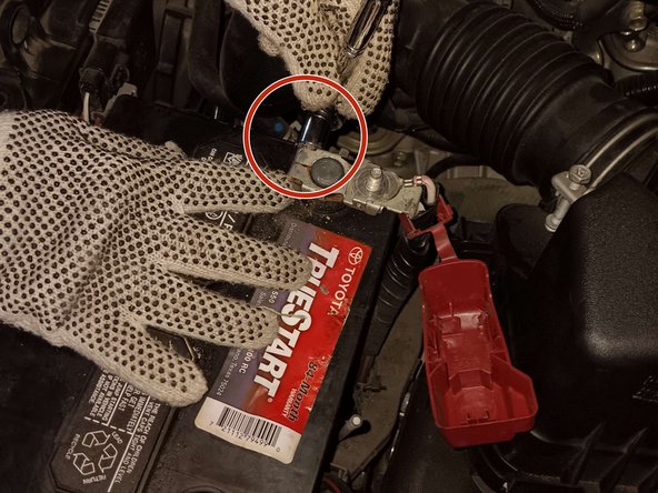

    • Disconnect the connector on the right with no coloring or cap.
    • Remove the vertically facing screw to disconnect the battery.
    • Loosen the clamp on the side directly connected to the battery.
    • Move both away from the battery once they've been disconnected/loosened enough to disconnect.

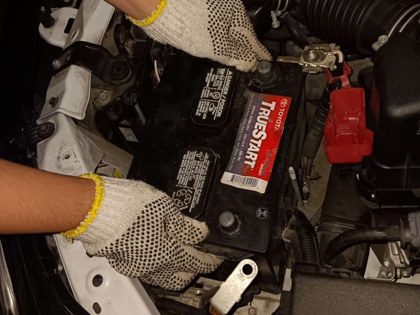

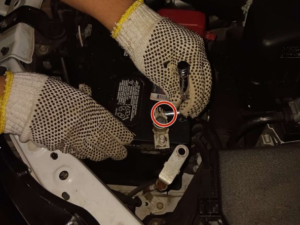

  4. 2018 Toyota Corolla LE Battery Replacement: crwdns2935265:04crwdnd2935265:01crwdnd2935265:03crwdne2935265:0 2018 Toyota Corolla LE Battery Replacement: crwdns2935265:04crwdnd2935265:02crwdnd2935265:03crwdne2935265:0 2018 Toyota Corolla LE Battery Replacement: crwdns2935265:04crwdnd2935265:03crwdnd2935265:03crwdne2935265:0
    • After removing the red cap on the second connector follow the same process you did with the right.
    • Remove the vertical screw first.
    • Loosen the horizontal screw on the side in order to fully free the battery.

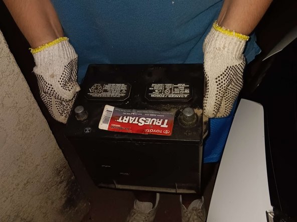

  5. 2018 Toyota Corolla LE Battery Replacement: crwdns2935265:05crwdnd2935265:01crwdnd2935265:03crwdne2935265:0 2018 Toyota Corolla LE Battery Replacement: crwdns2935265:05crwdnd2935265:02crwdnd2935265:03crwdne2935265:0 2018 Toyota Corolla LE Battery Replacement: crwdns2935265:05crwdnd2935265:03crwdnd2935265:03crwdne2935265:0
    • Car batteries are quite heavy so get ready to give a good lift.
    • Ensure you have a good grip on both ends and pull up both sides at once; you don't want the battery to tilt to one side

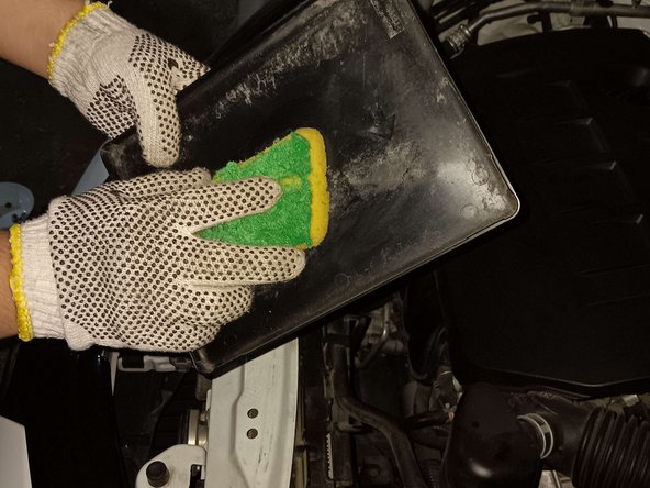

  6. 2018 Toyota Corolla LE Battery Replacement: crwdns2935265:06crwdnd2935265:01crwdnd2935265:02crwdne2935265:0 2018 Toyota Corolla LE Battery Replacement: crwdns2935265:06crwdnd2935265:02crwdnd2935265:02crwdne2935265:0
    • Pull out the tray that was holding the battery.
    • Clean off any dust or corrosion formed from use.
    • Place it back using the points on it to indicate how to fit it back in.
