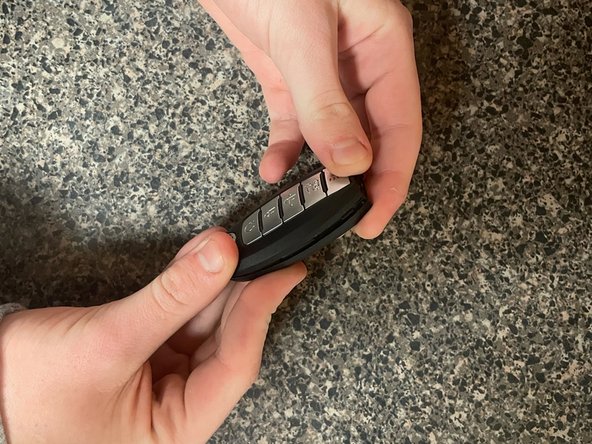

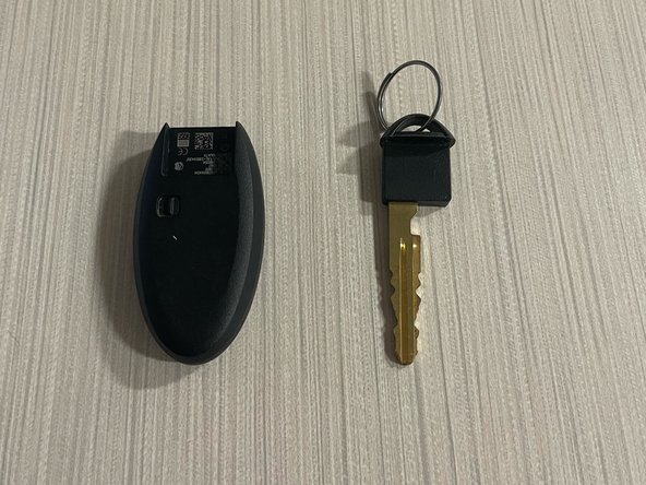

    • Pull the button on the back of the key fob from right to left while pulling the hoop on the top.
    • Completely remove the key from the fob.
  2. 2018 Nissan Murano Key Fob Battery Replacement: crwdns2935265:02crwdnd2935265:01crwdnd2935265:03crwdne2935265:0 2018 Nissan Murano Key Fob Battery Replacement: crwdns2935265:02crwdnd2935265:02crwdnd2935265:03crwdne2935265:0 2018 Nissan Murano Key Fob Battery Replacement: crwdns2935265:02crwdnd2935265:03crwdnd2935265:03crwdne2935265:0
    • Point the fob vertically towards you and find the groove between the front and the back.
    • Carefully, using an iFixit opening tool or similar household object, pry open the fob by sliding the flat end into the groove.
    • Slide your opening tool around the entire fob following the groove.
    • Pull apart the two main pieces.
