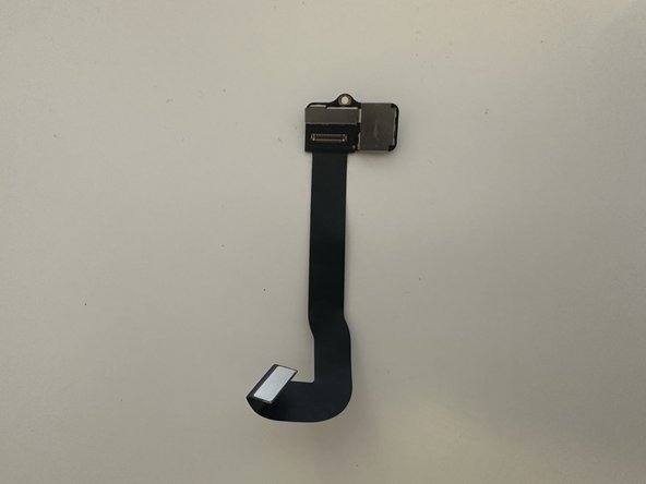

  29. 2018 MacBook Pro 13" Touch Bar Replacement, Audio socket / Touch ID bracket: crwdns2935265:029crwdnd2935265:01crwdnd2935265:02crwdne2935265:0 2018 MacBook Pro 13" Touch Bar Replacement, Audio socket / Touch ID bracket: crwdns2935265:029crwdnd2935265:02crwdnd2935265:02crwdne2935265:0
    • Use a T3 Torx driver to remove the two 1.4mm screws securing the bracket.
    • Remove the bracket.
  30. 2018 MacBook Pro 13" Touch Bar Replacement: crwdns2935265:030crwdnd2935265:01crwdnd2935265:03crwdne2935265:0 2018 MacBook Pro 13" Touch Bar Replacement: crwdns2935265:030crwdnd2935265:02crwdnd2935265:03crwdne2935265:0 2018 MacBook Pro 13" Touch Bar Replacement: crwdns2935265:030crwdnd2935265:03crwdnd2935265:03crwdne2935265:0
    • gently disconnect the audio socket flex cable with a spudger.
    • gently disconnect the Touch ID flex cable with a spudger.

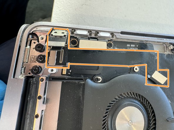

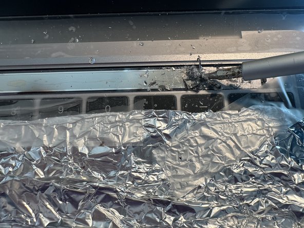

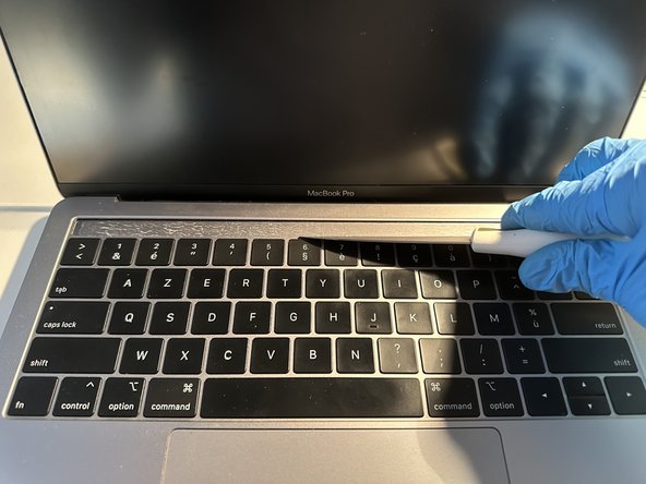

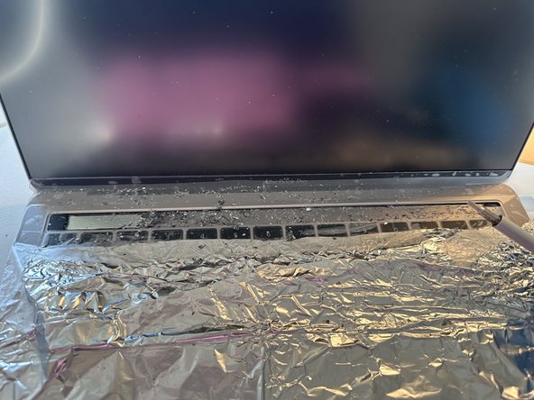

  35. 2018 MacBook Pro 13" Touch Bar Replacement, Prepare for the next steps: Identify the Touch Bar connectors: crwdns2935265:035crwdnd2935265:01crwdnd2935265:01crwdne2935265:0
    • In red you can see the two connectors for the Touch Bar. We will need to remove other parts first to be able to free them and be able to install the new connectors.
    • In green one notable screw that you need to remove because the board it holds in place prevents the Touch Bar connectors from exiting/entering through the main case of the MacBook.
    • We will therefore need to unplug both connectors, and remove the board, which takes a few additional steps that follow below.
  36. 2018 MacBook Pro 13" Touch Bar Replacement, Second Touch Bar connector: crwdns2935265:036crwdnd2935265:01crwdnd2935265:01crwdne2935265:0
    • Carefully unplug the second Touch Bar connector

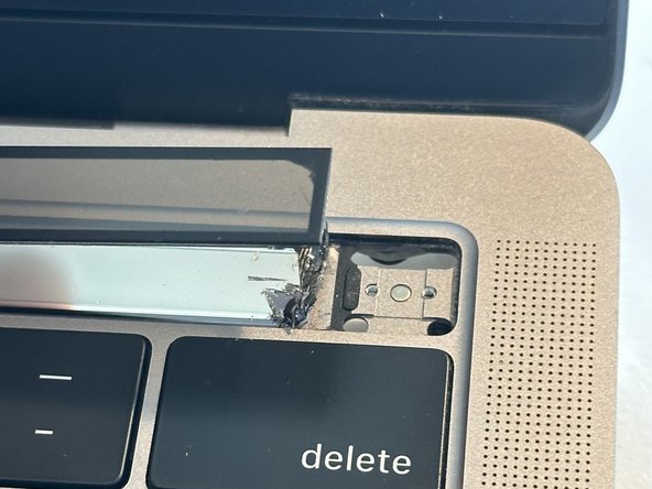

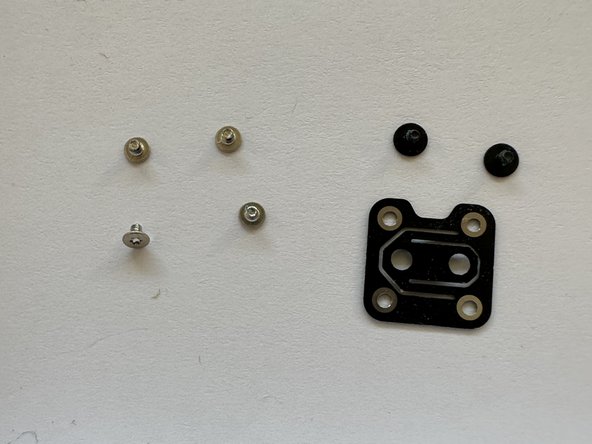

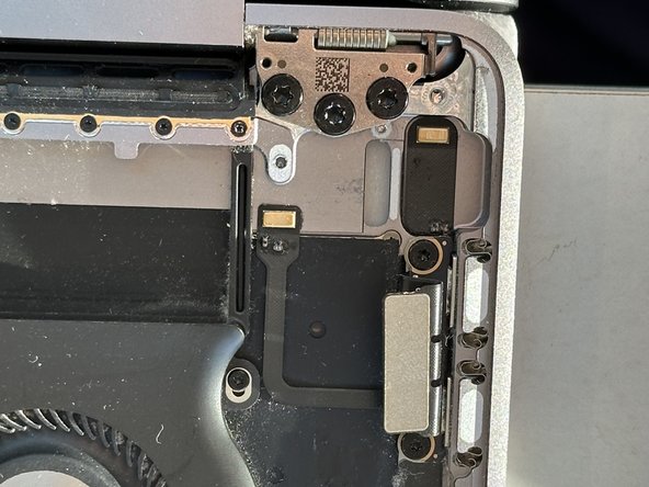

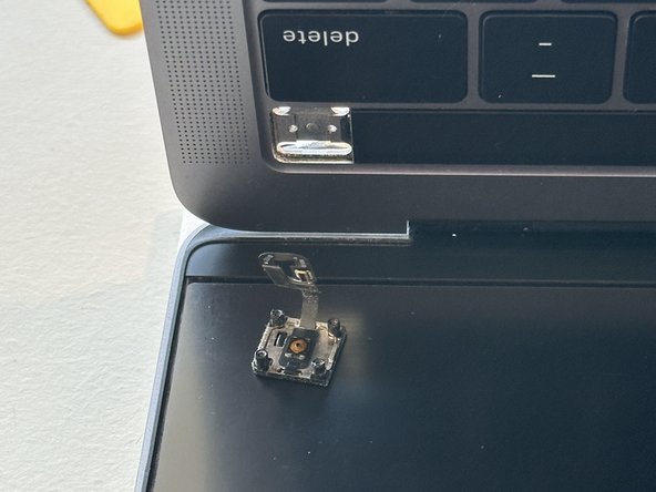

  37. 2018 MacBook Pro 13" Touch Bar Replacement, Touch ID sensor: crwdns2935265:037crwdnd2935265:01crwdnd2935265:03crwdne2935265:0 2018 MacBook Pro 13" Touch Bar Replacement, Touch ID sensor: crwdns2935265:037crwdnd2935265:02crwdnd2935265:03crwdne2935265:0 2018 MacBook Pro 13" Touch Bar Replacement, Touch ID sensor: crwdns2935265:037crwdnd2935265:03crwdnd2935265:03crwdne2935265:0
    • This is not strictly required. However I found when removing the Touch Bar that it necessitated a lot of scraping and force near the Touch ID sensor, thus I advise removing it for protection.
    • It is quite easy to remove, just be careful with the flex cable as it seems very fragile.
    • Remove the 4 red screws
    • Remove the 2 green screws
    • Remove the black bracket which is now free
    • Carefully open the laptop lid with the screen at the bottom. The Touch ID sensor should free itself and stay on the screen.

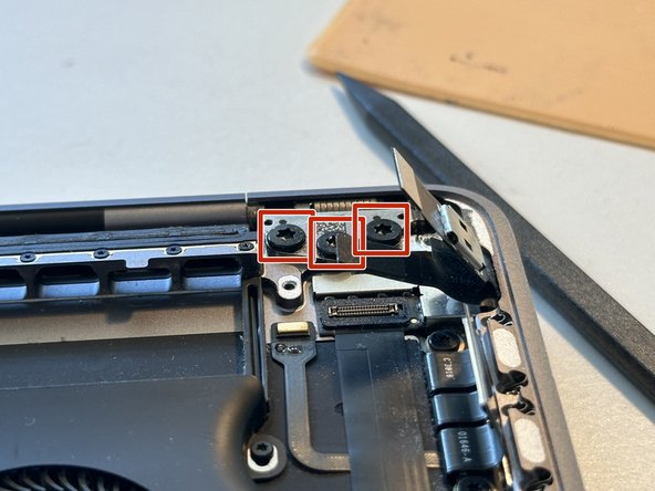

  38. 2018 MacBook Pro 13" Touch Bar Replacement, Loosen the screen hinge near the Touch Bar connectors: crwdns2935265:038crwdnd2935265:01crwdnd2935265:02crwdne2935265:0 2018 MacBook Pro 13" Touch Bar Replacement, Loosen the screen hinge near the Touch Bar connectors: crwdns2935265:038crwdnd2935265:02crwdnd2935265:02crwdne2935265:0
    • This is necessary in order to remove the Touch Bar board and screw
    • Loosen the 3 T8 screws of the screen hinge
    • Be careful not to completely remove those screws
    • Be careful to be very gentle with the hinge from then on not to exert too much force on the cables going through the hinge axis !
  39. 2018 MacBook Pro 13" Touch Bar Replacement, Touch Bar board: crwdns2935265:039crwdnd2935265:01crwdnd2935265:03crwdne2935265:0 2018 MacBook Pro 13" Touch Bar Replacement, Touch Bar board: crwdns2935265:039crwdnd2935265:02crwdnd2935265:03crwdne2935265:0 2018 MacBook Pro 13" Touch Bar Replacement, Touch Bar board: crwdns2935265:039crwdnd2935265:03crwdnd2935265:03crwdne2935265:0
    • Remove the red screw half hidden between the screen hinge (I already removed it in the picture)
    • This screw is smaller than T3 but I used a knife tip because I didn't have such a small screwdriver.
    • Then remove the Touch Bar board and its flex cable, they have some adhesive so be careful. The Touch Bar connectors are now freed to pass through and out of the main case !

    • Thanks to the removal of the Touch ID sensor, we have some room to get under the Touch Bar to remove it.
    • Seeing how messy the next steps got for my, I adise taping over the bottom of the screen and top of the keyboard to prevent any dirt bits getting stuck there. I put some tin foil over the rest of the keyboard but a paper or plastic sheet would be better.
    • I used a flathead screw driver but at first only the top glass popped off.
    • In the end I tried using an adhesive dissolver fluid, some thin spudgers, some fishing wire, but only brute force and the flat head screwdriver really solved it.
    • Please wear gloves and glasses as there are many glass shards flying about.
    • Keep scraping slowly but with force. This part took me about an hour.
  41. 2018 MacBook Pro 13" Touch Bar Replacement, Have patience and keep on going: crwdns2935265:041crwdnd2935265:01crwdnd2935265:03crwdne2935265:0 2018 MacBook Pro 13" Touch Bar Replacement, Have patience and keep on going: crwdns2935265:041crwdnd2935265:02crwdnd2935265:03crwdne2935265:0 2018 MacBook Pro 13" Touch Bar Replacement, Have patience and keep on going: crwdns2935265:041crwdnd2935265:03crwdnd2935265:03crwdne2935265:0
    • After finally removing the brunt of the Touch Bar material, I could remove the connectors going through the main body.
    • I spent some time scraping the remainders and the glue with different tools. Using a knife worked best, while being careful not to get injured or damage the screen.
    • The Touch Bar slot was somewhat scratched but in the end it didn't matter after installing a new Touch Bar.
