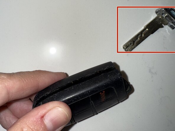

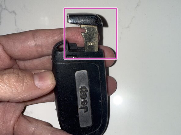

    • Remove the valet key from the top by sliding the button over.
    • You can not open the FOB without removing the valet key.

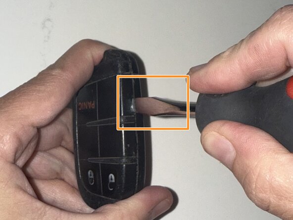

  2. 2018 Jeep Compass Key Fob Battery Replacement: crwdns2935265:02crwdnd2935265:01crwdnd2935265:01crwdne2935265:0
    • Use an opening tool or flathead screwdriver to separate the top and bottom of the key fob.

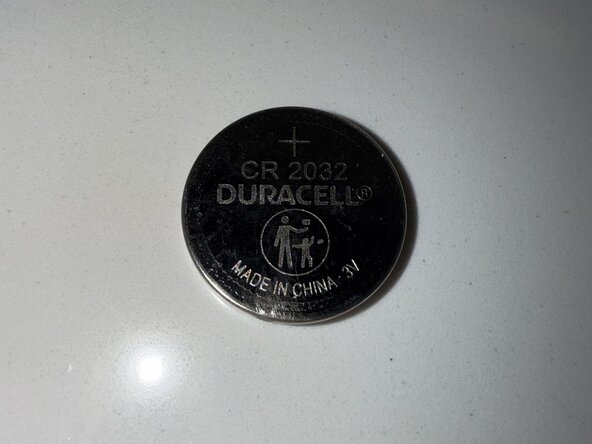

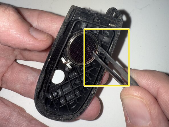

  3. 2018 Jeep Compass Key Fob Battery Replacement: crwdns2935265:03crwdnd2935265:01crwdnd2935265:03crwdne2935265:0 2018 Jeep Compass Key Fob Battery Replacement: crwdns2935265:03crwdnd2935265:02crwdnd2935265:03crwdne2935265:0 2018 Jeep Compass Key Fob Battery Replacement: crwdns2935265:03crwdnd2935265:03crwdnd2935265:03crwdne2935265:0

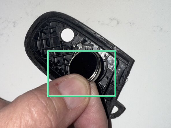

    • Use a spudger or pair of tweezers to pull the battery out.
    • Take care not to puncture the battery.
    • You can grab the battery with you fingers once the tweezers raise it out of the battery clasp.

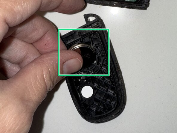

  4. 2018 Jeep Compass Key Fob Battery Replacement: crwdns2935265:04crwdnd2935265:01crwdnd2935265:01crwdne2935265:0
    • Replace the new battery in the battery holder.
    • Make sure that the battery is inserted correctly with positive(+) and negative(-) terminals corresponding with the symbols on the device, or the key fob will not work.

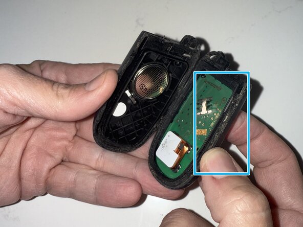

  5. 2018 Jeep Compass Key Fob Battery Replacement: crwdns2935265:05crwdnd2935265:01crwdnd2935265:01crwdne2935265:0
    • Align the two halves of the fob and press them together with your fingers until they snap into place.
