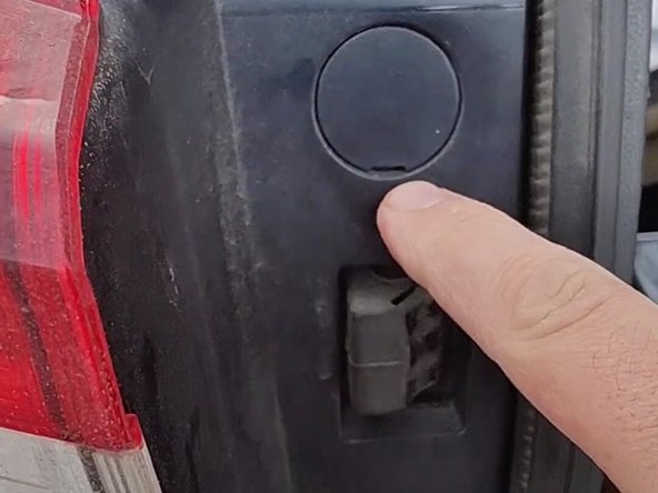

    • Open the trunk of your car so it stays up on its own.
  2. 2017-Present Subaru Impreza Tail Lamp Replacement: crwdns2935265:02crwdnd2935265:01crwdnd2935265:02crwdne2935265:0 2017-Present Subaru Impreza Tail Lamp Replacement: crwdns2935265:02crwdnd2935265:02crwdnd2935265:02crwdne2935265:0
    • Use a flathead screwdriver and place it in the divot to release the tab and remove the screw covers.
  3. 2017-Present Subaru Impreza Tail Lamp Replacement: crwdns2935265:03crwdnd2935265:01crwdnd2935265:01crwdne2935265:0
    • Use a Phillips #2 screwdriver to remove the two screws under the screw covers.
    • Tap the tail light assembly and pull it from the side to remove it from the vehicle.
  4. 2017-Present Subaru Impreza Tail Lamp Replacement: crwdns2935265:05crwdnd2935265:01crwdnd2935265:01crwdne2935265:0
    • Detach the tail light assembly connector from the car and remove the tail lamp completely.
