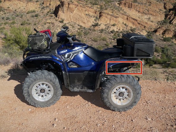

  1. 2017 Yamaha Kodiak SE EPS Muffler Replacement, Rack, seat, and fender.: crwdns2935265:01crwdnd2935265:01crwdnd2935265:03crwdne2935265:0 2017 Yamaha Kodiak SE EPS Muffler Replacement, Rack, seat, and fender.: crwdns2935265:01crwdnd2935265:02crwdnd2935265:03crwdne2935265:0 2017 Yamaha Kodiak SE EPS Muffler Replacement, Rack, seat, and fender.: crwdns2935265:01crwdnd2935265:03crwdnd2935265:03crwdne2935265:0
    • Take off the rear rack and the seat. Remove top cover, left side panel, floor board, and rear fender.

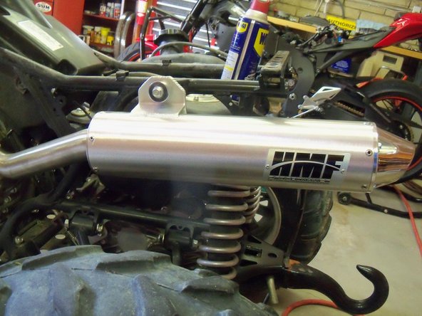

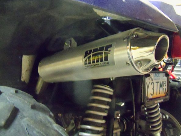

  3. 2017 Yamaha Kodiak SE EPS Muffler Replacement, New pipe.: crwdns2935265:03crwdnd2935265:01crwdnd2935265:03crwdne2935265:0 2017 Yamaha Kodiak SE EPS Muffler Replacement, New pipe.: crwdns2935265:03crwdnd2935265:02crwdnd2935265:03crwdne2935265:0 2017 Yamaha Kodiak SE EPS Muffler Replacement, New pipe.: crwdns2935265:03crwdnd2935265:03crwdnd2935265:03crwdne2935265:0
    • Slip new pipe on, reinstall retainer springs. Bolt hanger to frame. (no modifications necessary)
