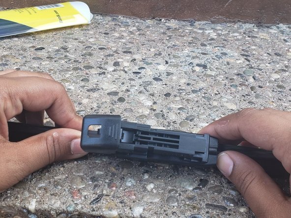

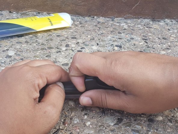

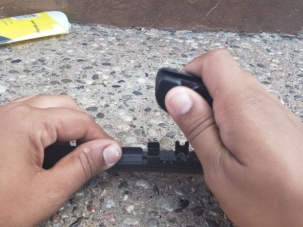

  4. 2017 Ford Escape Wiper Blades Replacement: crwdns2935265:04crwdnd2935265:01crwdnd2935265:03crwdne2935265:0 2017 Ford Escape Wiper Blades Replacement: crwdns2935265:04crwdnd2935265:02crwdnd2935265:03crwdne2935265:0 2017 Ford Escape Wiper Blades Replacement: crwdns2935265:04crwdnd2935265:03crwdnd2935265:03crwdne2935265:0
    • The 2017 Ford Escape has a PTB (Push Tab Button) arm. The Latitude wipers come with a pre-attached adapter as well as another one in the package. Remove the pre-attached adapter.
    • This requires quite a bit of effort.
    • Refrain from using a screwdriver to pry the adapter out since you may damage the blade.

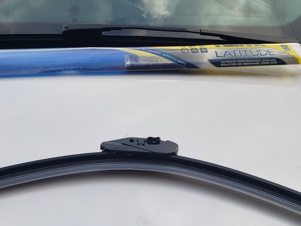

  5. 2017 Ford Escape Wiper Blades Replacement: crwdns2935265:05crwdnd2935265:01crwdnd2935265:03crwdne2935265:0 2017 Ford Escape Wiper Blades Replacement: crwdns2935265:05crwdnd2935265:02crwdnd2935265:03crwdne2935265:0 2017 Ford Escape Wiper Blades Replacement: crwdns2935265:05crwdnd2935265:03crwdnd2935265:03crwdne2935265:0
    • Install the new adapter ensuring the connector aligns with the blade assembly. The adapter must click for a secure fit.

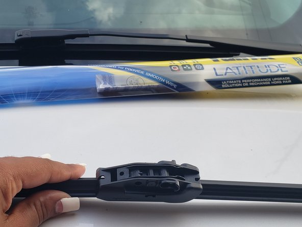

  6. 2017 Ford Escape Wiper Blades Replacement: crwdns2935265:06crwdnd2935265:01crwdnd2935265:01crwdne2935265:0
    • The top of the adapter has a tiny black housing. Fit the top of the wiper arm into the housing and align the bottom of the adapter with the tabs on the arm. Press firmly until you hear a click. Finally the wiper blade is installed.
