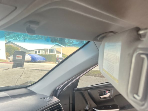

    • Using your hands, remove the protective cap to make the sun visor screws visible.

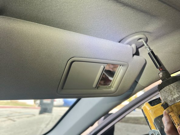

  2. 2016 Toyota Camry Sun Visor Replacement: crwdns2935265:02crwdnd2935265:01crwdnd2935265:03crwdne2935265:0 2016 Toyota Camry Sun Visor Replacement: crwdns2935265:02crwdnd2935265:02crwdnd2935265:03crwdne2935265:0 2016 Toyota Camry Sun Visor Replacement: crwdns2935265:02crwdnd2935265:03crwdnd2935265:03crwdne2935265:0
    • Use a Phillips #2 screwdriver or drill bit above the screws and align the drill bit to the head of the screw.
    • Gently remove the screws from their position.
