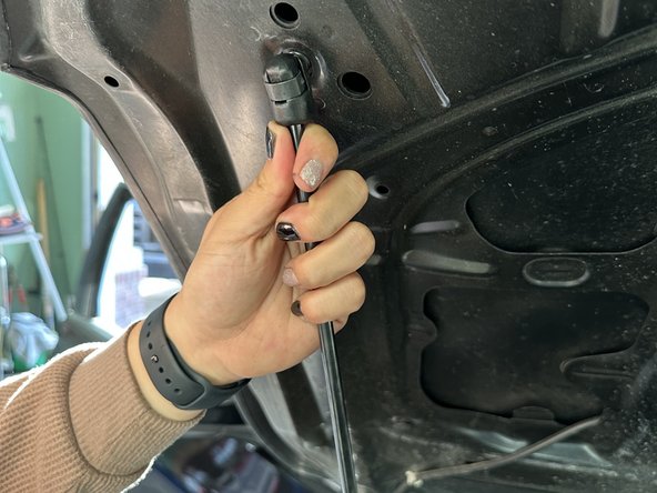

    • Use a pocket flathead screwdriver to get behind the metal clip.
    • Lift upwards and pry the metal clip out.
  2. 2016 Toyota Camry Hood Struts Replacement: crwdns2935265:02crwdnd2935265:01crwdnd2935265:02crwdne2935265:0 2016 Toyota Camry Hood Struts Replacement: crwdns2935265:02crwdnd2935265:02crwdnd2935265:02crwdne2935265:0
    • Repeat Step 1 for the bottom strut.
  3. 2016 Toyota Camry Hood Struts Replacement: crwdns2935265:03crwdnd2935265:01crwdnd2935265:02crwdne2935265:0 2016 Toyota Camry Hood Struts Replacement: crwdns2935265:03crwdnd2935265:02crwdnd2935265:02crwdne2935265:0
    • Pop the new hood strut into the socket and click it into place.
  • Hood Struts Replacement
    • Take a pocket flat head screwdriver
    • The strut has a metal clip that needs to be removed
    • Remove the ball of the strut from socket.
    • Once removed, repeat the same step for bottom strut
    • Install the new ones by simply pushing it onto the socket and clicking it.
