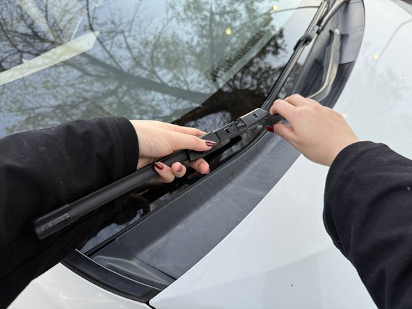

  3. 2016 Prius Windshield Wiper Replacement: crwdns2935265:03crwdnd2935265:01crwdnd2935265:03crwdne2935265:0 2016 Prius Windshield Wiper Replacement: crwdns2935265:03crwdnd2935265:02crwdnd2935265:03crwdne2935265:0 2016 Prius Windshield Wiper Replacement: crwdns2935265:03crwdnd2935265:03crwdnd2935265:03crwdne2935265:0
    • Be cautious, as the arm is spring loaded and letting it snap back can crack the windshield or damage your wipers.
    • You can put a towel down against the windshield if damaging it is a concern.
    • Carefully pull the wiper arm away from the windshield until it locks in an upright position.
    • To remove the old wiper blade, press the small tab or release clip at the point where the wiper blade connects to the wiper arm and slide it off.

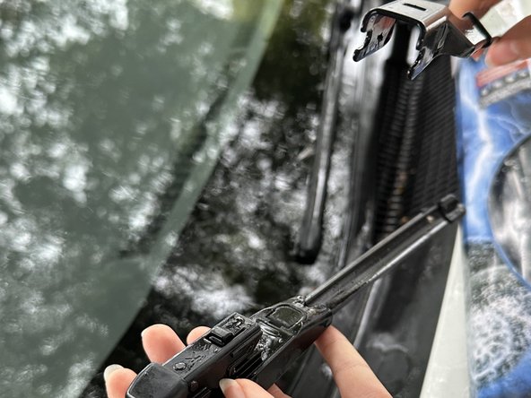

  4. 2016 Prius Windshield Wiper Replacement: crwdns2935265:04crwdnd2935265:01crwdnd2935265:02crwdne2935265:0 2016 Prius Windshield Wiper Replacement: crwdns2935265:04crwdnd2935265:02crwdnd2935265:02crwdne2935265:0
    • Open the new windshield wiper

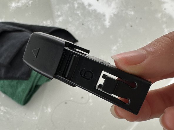

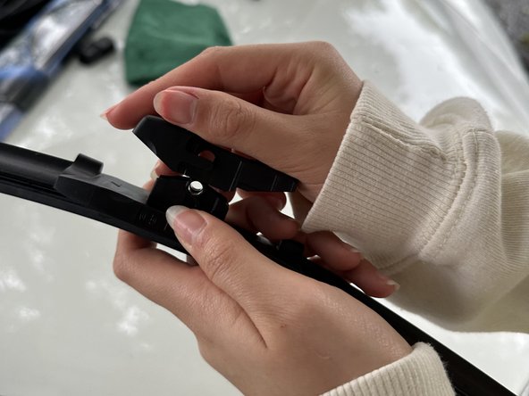

    • Remove the incorrect adapter piece by firmly holding the wiper in one hand and use upward force to pry it off.

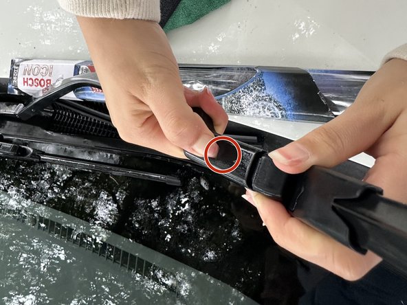

  5. 2016 Prius Windshield Wiper Replacement: crwdns2935265:05crwdnd2935265:01crwdnd2935265:03crwdne2935265:0 2016 Prius Windshield Wiper Replacement: crwdns2935265:05crwdnd2935265:02crwdnd2935265:03crwdne2935265:0 2016 Prius Windshield Wiper Replacement: crwdns2935265:05crwdnd2935265:03crwdnd2935265:03crwdne2935265:0
    • Find the bag of additional adapter pieces that come with the windshield wiper and pull out the one labeled #6.
    • Make sure the guidance arrows are pointing in the same direction.
    • To attach the #6 adapter, align the adapter and blade and push using downward force until you hear them click into place.

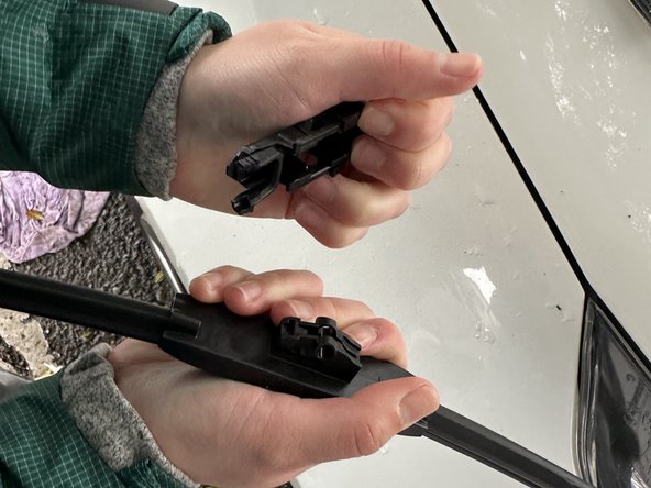

  6. 2016 Prius Windshield Wiper Replacement: crwdns2935265:06crwdnd2935265:01crwdnd2935265:02crwdne2935265:0 2016 Prius Windshield Wiper Replacement: crwdns2935265:06crwdnd2935265:02crwdnd2935265:02crwdne2935265:0
    • Now that the correct adapter is attached, align the new wiper blade with the hook on the wiper arm.
    • Slide the wiper blade in until you hear a click, indicating it’s securely locked in place.
    • Double-check that it’s fastened to avoid it detaching while in use.
