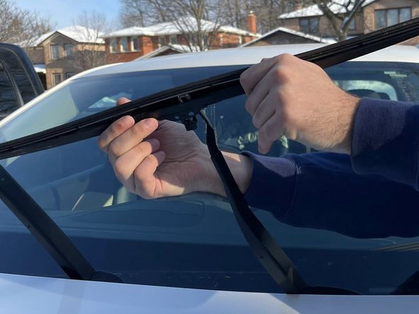

    • If the broken wiper is located on the passenger side, then you will need to purchase an 18-inch wiper.
    • If the damaged wiper is located on the driver side, then you will need a 26-inch wiper.

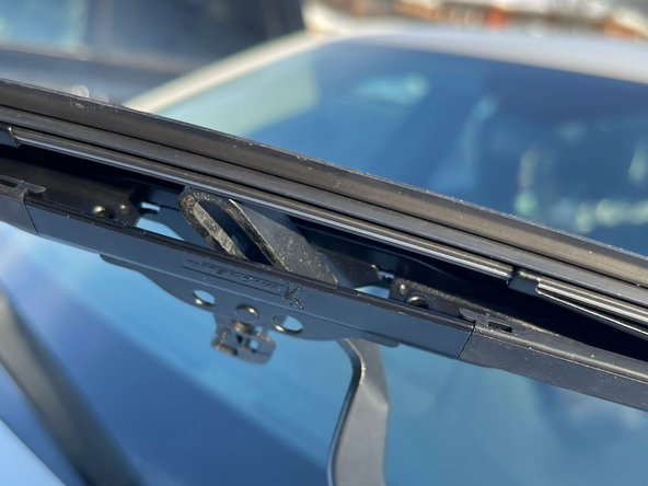

  2. 2016 Jeep Cherokee Windshield Wiper Replacement: crwdns2935265:02crwdnd2935265:01crwdnd2935265:03crwdne2935265:0 2016 Jeep Cherokee Windshield Wiper Replacement: crwdns2935265:02crwdnd2935265:02crwdnd2935265:03crwdne2935265:0 2016 Jeep Cherokee Windshield Wiper Replacement: crwdns2935265:02crwdnd2935265:03crwdnd2935265:03crwdne2935265:0
    • Most blades are held in place with a tiny clip.
    • Push that clip up, while you are pushing the blade backwards.
  3. 2016 Jeep Cherokee Windshield Wiper Replacement: crwdns2935265:03crwdnd2935265:01crwdnd2935265:01crwdne2935265:0
    • Once you get the blade free from the hook, push the blade down to disconnect it.
  4. 2016 Jeep Cherokee Windshield Wiper Replacement: crwdns2935265:04crwdnd2935265:01crwdnd2935265:03crwdne2935265:0 2016 Jeep Cherokee Windshield Wiper Replacement: crwdns2935265:04crwdnd2935265:02crwdnd2935265:03crwdne2935265:0 2016 Jeep Cherokee Windshield Wiper Replacement: crwdns2935265:04crwdnd2935265:03crwdnd2935265:03crwdne2935265:0
    • After disconnecting the old wiper, position the new blade so that the hook points toward the area where you just detached the old wiper.
  5. 2016 Jeep Cherokee Windshield Wiper Replacement: crwdns2935265:05crwdnd2935265:01crwdnd2935265:01crwdne2935265:0
    • Push the blade towards the arm.
    • Make sure the hook is inside the arm.
    • When completed, you will hear it click, this means that the wiper has been successfully installed.
