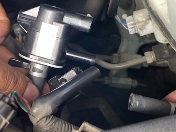

    • Locate the purge valve on the engine. It is on the exhaust manifold near the cylinder head. It may have a round plastic gas cap at one end and a flange with an electrical connector at the other end.
  2. 2015 Toyota Camry Purge Valve Replacement: crwdns2935265:02crwdnd2935265:01crwdnd2935265:03crwdne2935265:0 2015 Toyota Camry Purge Valve Replacement: crwdns2935265:02crwdnd2935265:02crwdnd2935265:03crwdne2935265:0 2015 Toyota Camry Purge Valve Replacement: crwdns2935265:02crwdnd2935265:03crwdnd2935265:03crwdne2935265:0

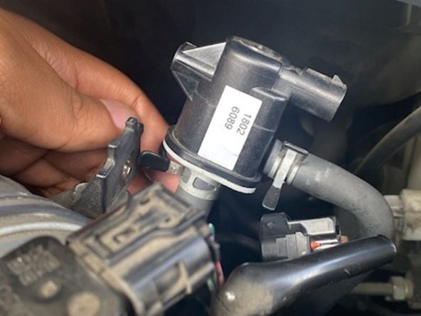

    • Use a Cross slot/Phillips screwdriver and take out the screw that is used to hold the purge valve in place. Rotate the screwdriver to the left until the screw is fully out.
  3. 2015 Toyota Camry Purge Valve Replacement: crwdns2935265:03crwdnd2935265:01crwdnd2935265:02crwdne2935265:0 2015 Toyota Camry Purge Valve Replacement: crwdns2935265:03crwdnd2935265:02crwdnd2935265:02crwdne2935265:0
    • Disconnect the electrical connector from the purge valve by gently pulling it away from the valve.
  4. 2015 Toyota Camry Purge Valve Replacement: crwdns2935265:04crwdnd2935265:01crwdnd2935265:01crwdne2935265:0

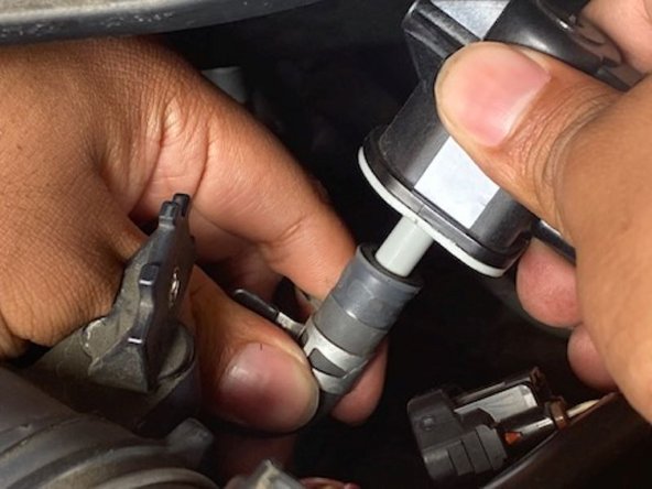

    • Apply a few drops of WD-40 at the bottom and right hose to loosen them and make removing them more manageable.
  5. 2015 Toyota Camry Purge Valve Replacement: crwdns2935265:05crwdnd2935265:01crwdnd2935265:03crwdne2935265:0 2015 Toyota Camry Purge Valve Replacement: crwdns2935265:05crwdnd2935265:02crwdnd2935265:03crwdne2935265:0 2015 Toyota Camry Purge Valve Replacement: crwdns2935265:05crwdnd2935265:03crwdnd2935265:03crwdne2935265:0
    • You should be able to remove the hose's by hand but use a slip joint pillar if it is difficult. The hose's should then simply slide off and in doing so gently lift the valve away from the engine.
  6. 2015 Toyota Camry Purge Valve Replacement: crwdns2935265:06crwdnd2935265:01crwdnd2935265:01crwdne2935265:0
    • Now that you have removed the part, you may connect the new purge valve of your choice.
