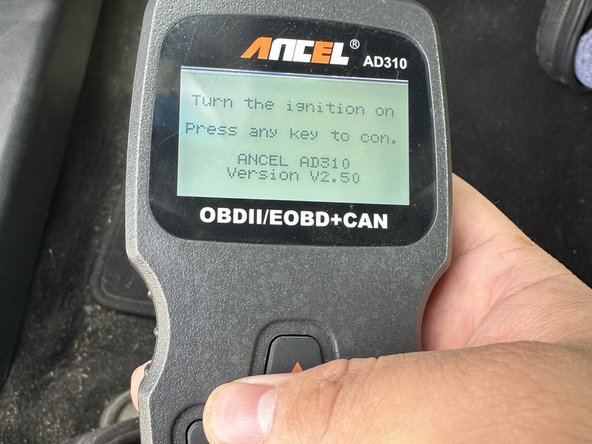

  2. 2015 Nissan Altima Mass Air Flow Sensor Replacement: crwdns2935265:02crwdnd2935265:01crwdnd2935265:03crwdne2935265:0 2015 Nissan Altima Mass Air Flow Sensor Replacement: crwdns2935265:02crwdnd2935265:02crwdnd2935265:03crwdne2935265:0 2015 Nissan Altima Mass Air Flow Sensor Replacement: crwdns2935265:02crwdnd2935265:03crwdnd2935265:03crwdne2935265:0
    • Connect a scanner by clicking it into the obd2 port.
  3. 2015 Nissan Altima Mass Air Flow Sensor Replacement: crwdns2935265:03crwdnd2935265:01crwdnd2935265:03crwdne2935265:0 2015 Nissan Altima Mass Air Flow Sensor Replacement: crwdns2935265:03crwdnd2935265:02crwdnd2935265:03crwdne2935265:0 2015 Nissan Altima Mass Air Flow Sensor Replacement: crwdns2935265:03crwdnd2935265:03crwdnd2935265:03crwdne2935265:0

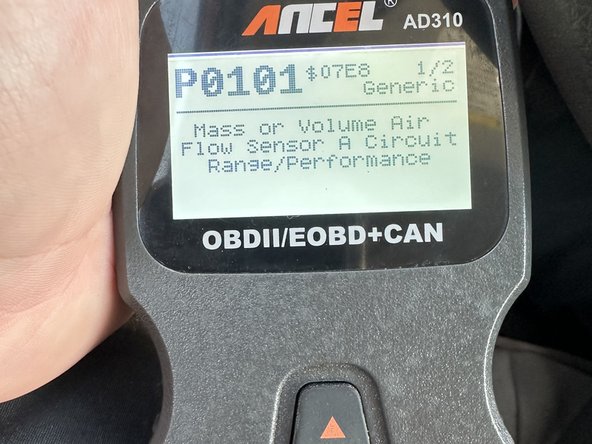

    • Run the code through the scanner.

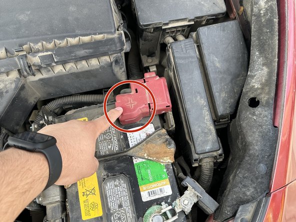

  5. 2015 Nissan Altima Mass Air Flow Sensor Replacement: crwdns2935265:05crwdnd2935265:01crwdnd2935265:03crwdne2935265:0 2015 Nissan Altima Mass Air Flow Sensor Replacement: crwdns2935265:05crwdnd2935265:02crwdnd2935265:03crwdne2935265:0 2015 Nissan Altima Mass Air Flow Sensor Replacement: crwdns2935265:05crwdnd2935265:03crwdnd2935265:03crwdne2935265:0

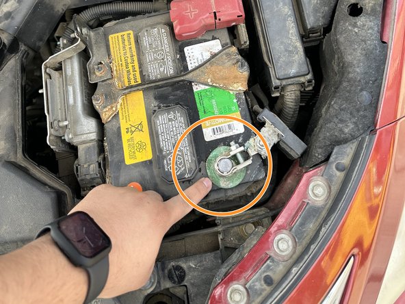

    • Locate the battery and a positive and negative terminal.
    • The Positive terminal.
    • The Negative terminal.
    • Be careful risk of electrical shock
  6. 2015 Nissan Altima Mass Air Flow Sensor Replacement: crwdns2935265:06crwdnd2935265:01crwdnd2935265:03crwdne2935265:0 2015 Nissan Altima Mass Air Flow Sensor Replacement: crwdns2935265:06crwdnd2935265:02crwdnd2935265:03crwdne2935265:0 2015 Nissan Altima Mass Air Flow Sensor Replacement: crwdns2935265:06crwdnd2935265:03crwdnd2935265:03crwdne2935265:0

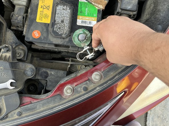

    • Unscrew the positive terminal with a 10mm wrench by turning it counterclockwise.

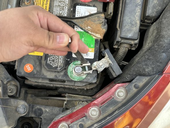

    • Unscrew the negative terminal with a 10mm wrench by turning it counterclockwise.

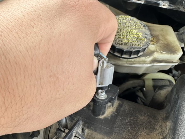

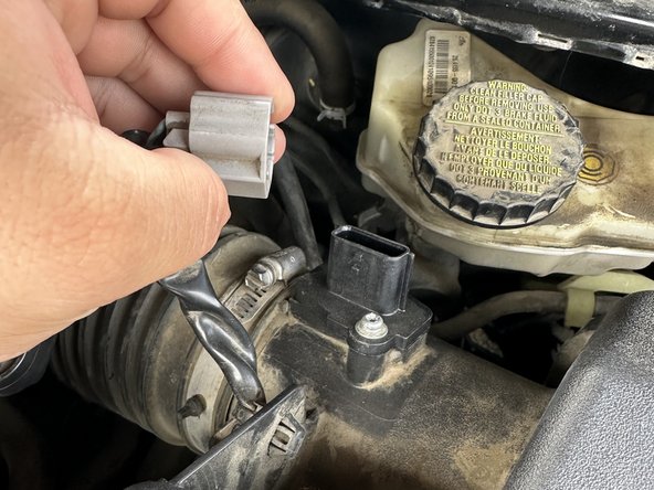

  8. 2015 Nissan Altima Mass Air Flow Sensor Replacement: crwdns2935265:08crwdnd2935265:01crwdnd2935265:03crwdne2935265:0 2015 Nissan Altima Mass Air Flow Sensor Replacement: crwdns2935265:08crwdnd2935265:02crwdnd2935265:03crwdne2935265:0 2015 Nissan Altima Mass Air Flow Sensor Replacement: crwdns2935265:08crwdnd2935265:03crwdnd2935265:03crwdne2935265:0

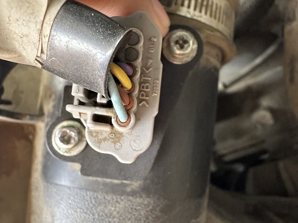

    • Unplug the mass air flow sensor by pushing in the pull tabs and pulling upwards.

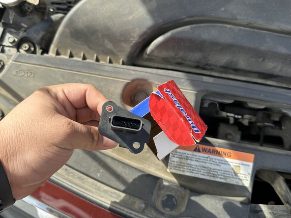

  10. 2015 Nissan Altima Mass Air Flow Sensor Replacement: crwdns2935265:010crwdnd2935265:01crwdnd2935265:03crwdne2935265:0 2015 Nissan Altima Mass Air Flow Sensor Replacement: crwdns2935265:010crwdnd2935265:02crwdnd2935265:03crwdne2935265:0 2015 Nissan Altima Mass Air Flow Sensor Replacement: crwdns2935265:010crwdnd2935265:03crwdnd2935265:03crwdne2935265:0

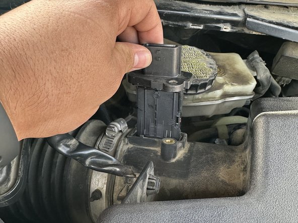

    • Remove the old sensor by pulling it off and replace with a new one.

  13. 2015 Nissan Altima Mass Air Flow Sensor Replacement: crwdns2935265:013crwdnd2935265:01crwdnd2935265:03crwdne2935265:0 2015 Nissan Altima Mass Air Flow Sensor Replacement: crwdns2935265:013crwdnd2935265:02crwdnd2935265:03crwdne2935265:0 2015 Nissan Altima Mass Air Flow Sensor Replacement: crwdns2935265:013crwdnd2935265:03crwdnd2935265:03crwdne2935265:0
    • Run the scanner again and make sure no check engine light is on and no trouble codes appear.
