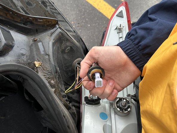

  5. 2015 Ford Focus Brake Light Replacement: crwdns2935265:05crwdnd2935265:01crwdnd2935265:03crwdne2935265:0 2015 Ford Focus Brake Light Replacement: crwdns2935265:05crwdnd2935265:02crwdnd2935265:03crwdne2935265:0 2015 Ford Focus Brake Light Replacement: crwdns2935265:05crwdnd2935265:03crwdnd2935265:03crwdne2935265:0
    • Twist the light bulb socket a quarter turn to the right to take out the light bulb compartment.

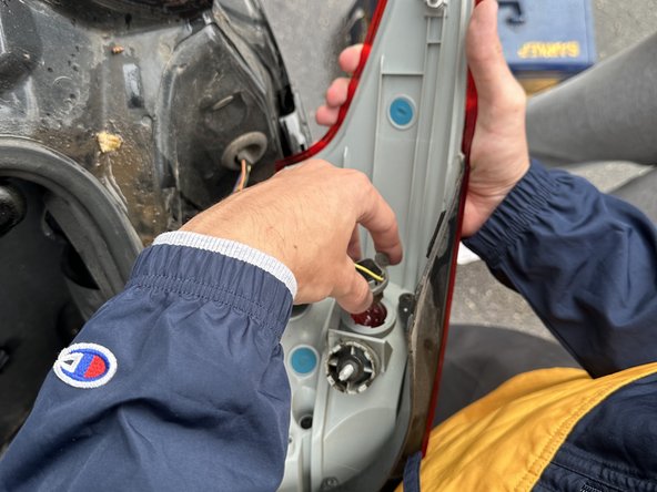

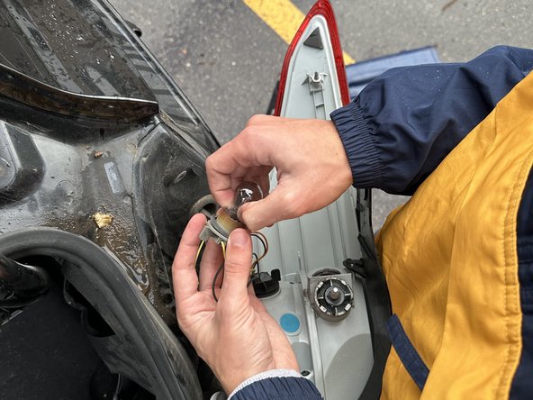

  6. 2015 Ford Focus Brake Light Replacement: crwdns2935265:06crwdnd2935265:01crwdnd2935265:02crwdne2935265:0 2015 Ford Focus Brake Light Replacement: crwdns2935265:06crwdnd2935265:02crwdnd2935265:02crwdne2935265:0
    • Pull out the old light bulb from the socket.

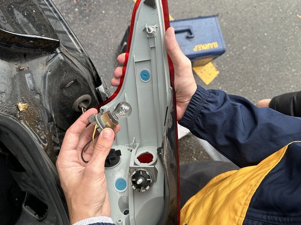

  7. 2015 Ford Focus Brake Light Replacement: crwdns2935265:07crwdnd2935265:01crwdnd2935265:03crwdne2935265:0 2015 Ford Focus Brake Light Replacement: crwdns2935265:07crwdnd2935265:02crwdnd2935265:03crwdne2935265:0 2015 Ford Focus Brake Light Replacement: crwdns2935265:07crwdnd2935265:03crwdnd2935265:03crwdne2935265:0
    • Push the new light bulb into the light bulb socket.
