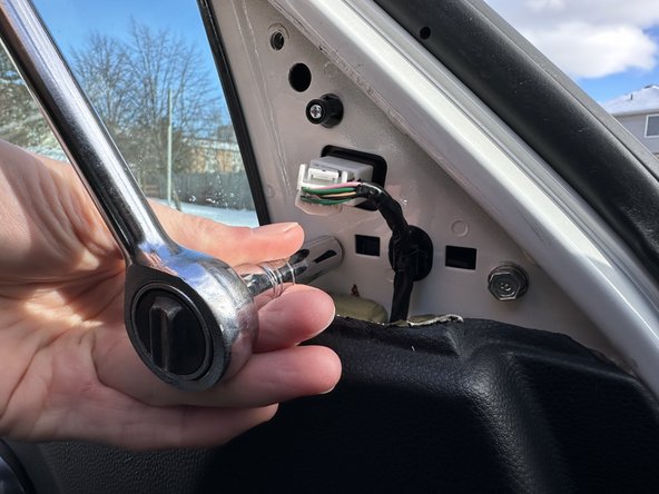

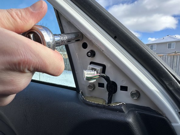

  3. 2014-Present Kia Soul Side Mirror Replacement: crwdns2935265:03crwdnd2935265:01crwdnd2935265:03crwdne2935265:0 2014-Present Kia Soul Side Mirror Replacement: crwdns2935265:03crwdnd2935265:02crwdnd2935265:03crwdne2935265:0 2014-Present Kia Soul Side Mirror Replacement: crwdns2935265:03crwdnd2935265:03crwdnd2935265:03crwdne2935265:0
    • Use a 10 mm socket wrench to remove the three 10 mm bolts holding the mirror to the window.

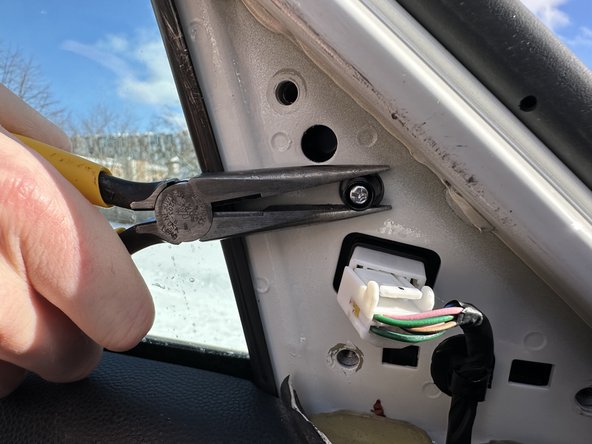

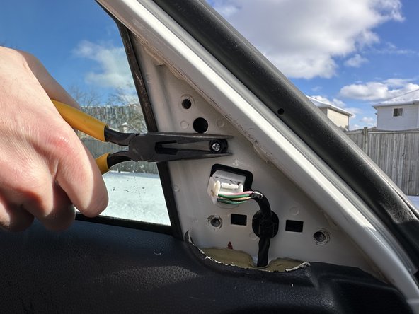

  4. 2014-Present Kia Soul Side Mirror Replacement: crwdns2935265:04crwdnd2935265:01crwdnd2935265:03crwdne2935265:0 2014-Present Kia Soul Side Mirror Replacement: crwdns2935265:04crwdnd2935265:02crwdnd2935265:03crwdne2935265:0 2014-Present Kia Soul Side Mirror Replacement: crwdns2935265:04crwdnd2935265:03crwdnd2935265:03crwdne2935265:0
    • When working on this step, hold onto the side mirror to prevent it from falling. It may be helpful to have someone assist you during this step.
    • Use needle nose pliers to grip the grommet (plastic anchor around the screw) and guide it through the hole to detach the side mirror from the car.
    • Make sure to clamp all four sides of the grommet simultaneously to guide it through the opening. Do not turn or remove the screw during this process.

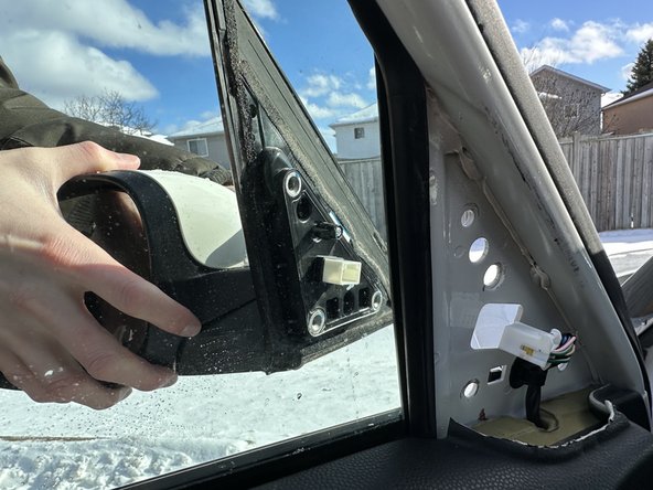

  5. 2014-Present Kia Soul Side Mirror Replacement: crwdns2935265:05crwdnd2935265:01crwdnd2935265:02crwdne2935265:0 2014-Present Kia Soul Side Mirror Replacement: crwdns2935265:05crwdnd2935265:02crwdnd2935265:02crwdne2935265:0
    • Remove the side mirror from the car.
    • It should come off in one piece.
    • Be careful to not drop the side mirror as the fragile glass could shatter.
