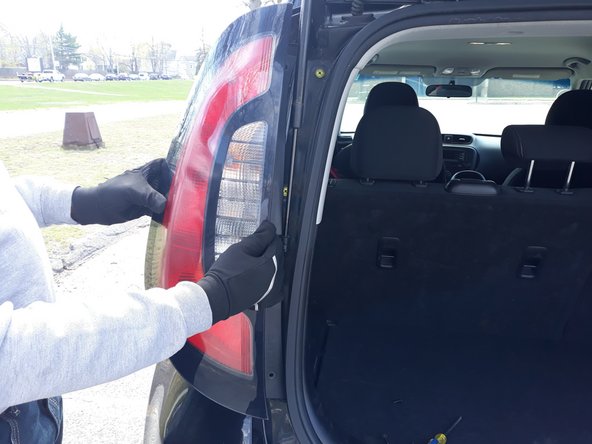

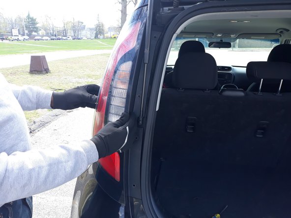

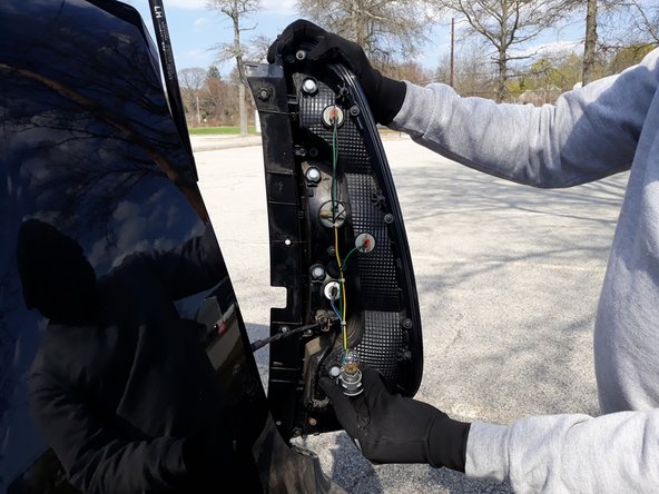

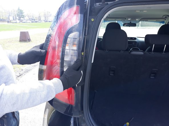

    • Open the car trunk.

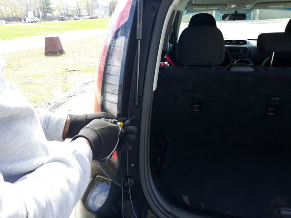

  2. 2014-Present Kia Soul Brake Light Replacement: crwdns2935265:02crwdnd2935265:01crwdnd2935265:02crwdne2935265:0 2014-Present Kia Soul Brake Light Replacement: crwdns2935265:02crwdnd2935265:02crwdnd2935265:02crwdne2935265:0
    • Use a Phillips #2 screwdriver to remove the four 20.0 mm screws from the tail light assembly.
  3. 2014-Present Kia Soul Brake Light Replacement: crwdns2935265:03crwdnd2935265:01crwdnd2935265:03crwdne2935265:0 2014-Present Kia Soul Brake Light Replacement: crwdns2935265:03crwdnd2935265:02crwdnd2935265:03crwdne2935265:0 2014-Present Kia Soul Brake Light Replacement: crwdns2935265:03crwdnd2935265:03crwdnd2935265:03crwdne2935265:0
    • Pull the tail light assembly off.
    • Apply a counterclockwise motion on the tail light while you are pulling it off.
    • Do not use too much force to prevent cracking the plastic lens.

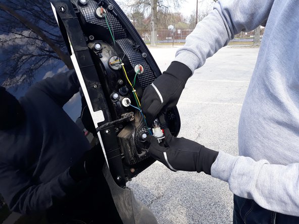

  4. 2014-Present Kia Soul Brake Light Replacement: crwdns2935265:04crwdnd2935265:01crwdnd2935265:03crwdne2935265:0 2014-Present Kia Soul Brake Light Replacement: crwdns2935265:04crwdnd2935265:02crwdnd2935265:03crwdne2935265:0 2014-Present Kia Soul Brake Light Replacement: crwdns2935265:04crwdnd2935265:03crwdnd2935265:03crwdne2935265:0
    • Turn the brake light socket 1/4 counterclockwise and pull it from the tail light assembly.
    • The brake light is located at the bottom of the tail light assembly.

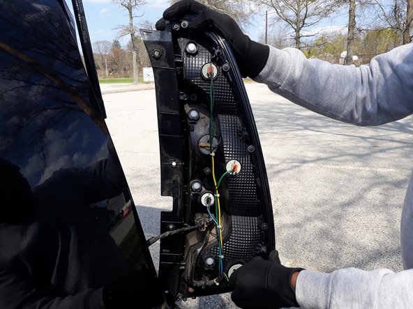

  5. 2014-Present Kia Soul Brake Light Replacement: crwdns2935265:05crwdnd2935265:01crwdnd2935265:01crwdne2935265:0
    • Press the light bulb down and turn it 1/4 counterclockwise.

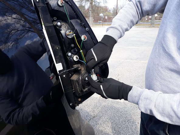

  6. 2014-Present Kia Soul Brake Light Replacement: crwdns2935265:06crwdnd2935265:01crwdnd2935265:01crwdne2935265:0
    • Pull the light bulb out of the socket.
  7. 2014-Present Kia Soul Brake Light Replacement: crwdns2935265:07crwdnd2935265:01crwdnd2935265:03crwdne2935265:0 2014-Present Kia Soul Brake Light Replacement: crwdns2935265:07crwdnd2935265:02crwdnd2935265:03crwdne2935265:0 2014-Present Kia Soul Brake Light Replacement: crwdns2935265:07crwdnd2935265:03crwdnd2935265:03crwdne2935265:0
    • Press the new light bulb down into the socket and turn it 1/4 clockwise direction.
    • Before performing this action make sure you properly place the light bulb into the socket.
  8. 2014-Present Kia Soul Brake Light Replacement: crwdns2935265:08crwdnd2935265:01crwdnd2935265:03crwdne2935265:0 2014-Present Kia Soul Brake Light Replacement: crwdns2935265:08crwdnd2935265:02crwdnd2935265:03crwdne2935265:0 2014-Present Kia Soul Brake Light Replacement: crwdns2935265:08crwdnd2935265:03crwdnd2935265:03crwdne2935265:0
    • Follow the guide in reverse order to put the socket and the tail light assembly back.
    • Before you screw the tail light assembly back have someone press the brake paddle to see if the new light bulb turns on.
