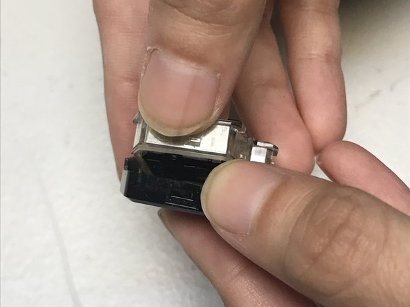

    • Grab the remote and grip where the edges meet.
    • Pull on the two covers until they come off.

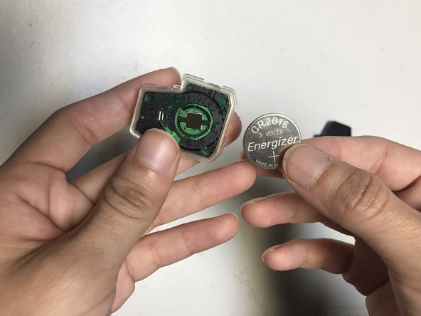

    • Lift the battery out using a prying tool.
  5. 2014 Toyota Corolla Key Fob Battery Replacement: crwdns2935265:05crwdnd2935265:01crwdnd2935265:02crwdne2935265:0 2014 Toyota Corolla Key Fob Battery Replacement: crwdns2935265:05crwdnd2935265:02crwdnd2935265:02crwdne2935265:0
    • Remove the battery from the key fob.
  6. 2014 Toyota Corolla Key Fob Battery Replacement: crwdns2935265:06crwdnd2935265:01crwdnd2935265:01crwdne2935265:0
    • Insert the new battery into the bracket.
