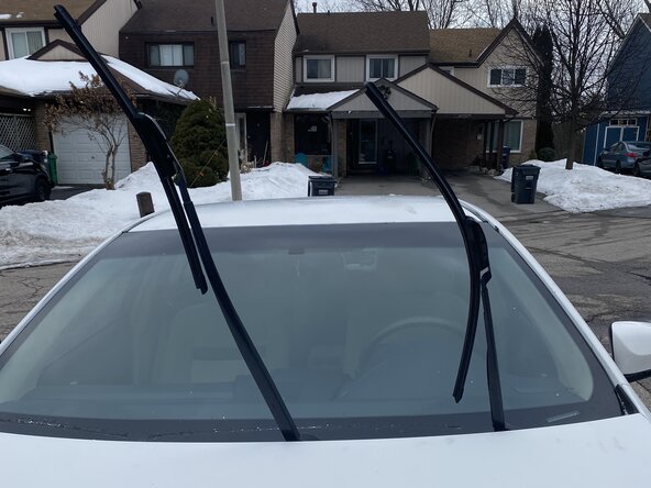

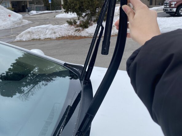

    • Lift up both wipers and assess any damage.
    • Make sure the car is off before starting the repair.

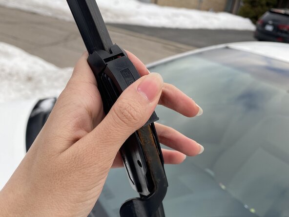

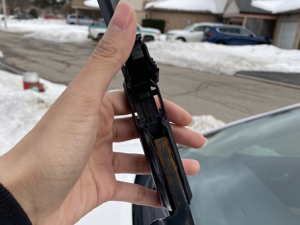

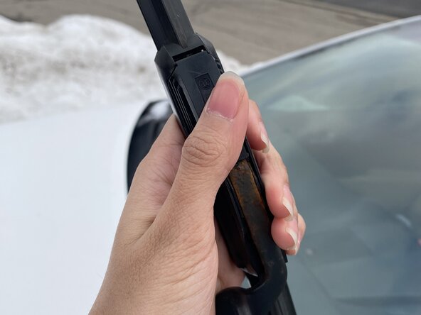

    • Locate the clasp which secures the wiper blades.

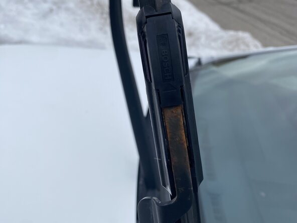

  3. 2014 Toyota Camry Windshield Wipers Replacement: crwdns2935265:03crwdnd2935265:01crwdnd2935265:02crwdne2935265:0 2014 Toyota Camry Windshield Wipers Replacement: crwdns2935265:03crwdnd2935265:02crwdnd2935265:02crwdne2935265:0
    • Flip open the clasp of the wiper blade, revealing the hook of the wiper.

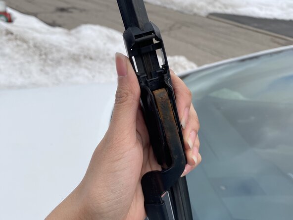

  4. 2014 Toyota Camry Windshield Wipers Replacement: crwdns2935265:04crwdnd2935265:01crwdnd2935265:03crwdne2935265:0 2014 Toyota Camry Windshield Wipers Replacement: crwdns2935265:04crwdnd2935265:02crwdnd2935265:03crwdne2935265:0 2014 Toyota Camry Windshield Wipers Replacement: crwdns2935265:04crwdnd2935265:03crwdnd2935265:03crwdne2935265:0
    • Pull down on the blade to remove the blade from the rest of the wiper.
    • Falling blades may shatter the windshield. Make sure to either hold onto the wiper or lay it flat on a piece of cloth to prevent any damages or injury.

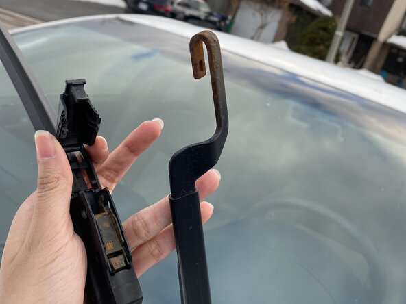

  5. 2014 Toyota Camry Windshield Wipers Replacement: crwdns2935265:05crwdnd2935265:01crwdnd2935265:02crwdne2935265:0 2014 Toyota Camry Windshield Wipers Replacement: crwdns2935265:05crwdnd2935265:02crwdnd2935265:02crwdne2935265:0
    • To attach a new blade, line it up the same way as the old one. Slide it up into the hook to attach.

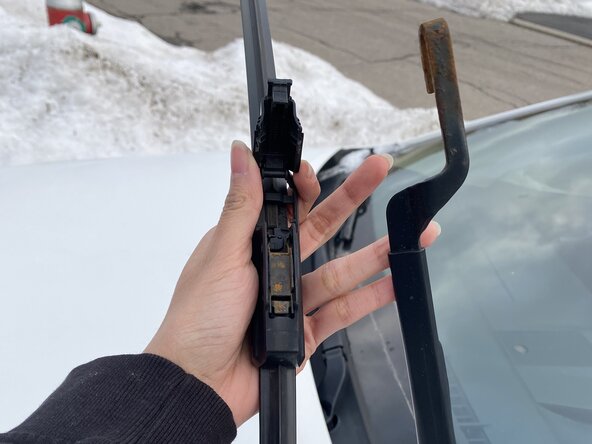

  6. 2014 Toyota Camry Windshield Wipers Replacement: crwdns2935265:06crwdnd2935265:01crwdnd2935265:03crwdne2935265:0 2014 Toyota Camry Windshield Wipers Replacement: crwdns2935265:06crwdnd2935265:02crwdnd2935265:03crwdne2935265:0 2014 Toyota Camry Windshield Wipers Replacement: crwdns2935265:06crwdnd2935265:03crwdnd2935265:03crwdne2935265:0
    • Close the clasp on the wiper to secure the new blade.
  7. 2014 Toyota Camry Windshield Wipers Replacement: crwdns2935265:07crwdnd2935265:01crwdnd2935265:01crwdne2935265:0
    • Lay the wipers down gently. Repeat the same process on all other wipers.
