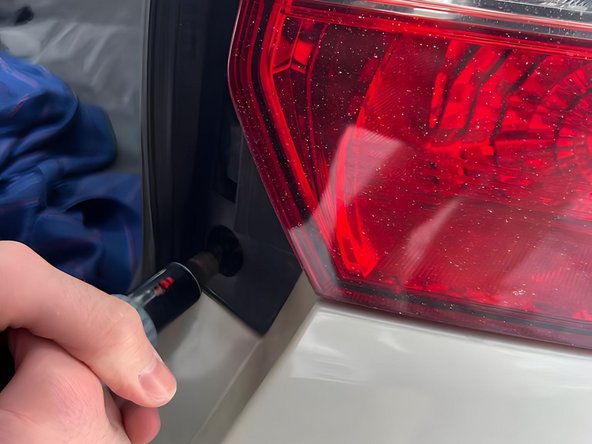

    • Unscrew the both the 2 cm Phillips #3 screws encircled in the image shown with a Phillips #3 screw driver.
    • Unscrewing them will allow you to take out the brake light.
  4. 2014 Subaru Impreza Hatchback Brake light Replacement: crwdns2935265:04crwdnd2935265:01crwdnd2935265:02crwdne2935265:0 2014 Subaru Impreza Hatchback Brake light Replacement: crwdns2935265:04crwdnd2935265:02crwdnd2935265:02crwdne2935265:0
    • Unscrew both the 2 cm Phillips #3 screws by turning the screwdriver counterclockwise.

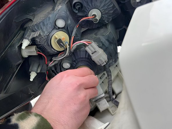

  6. 2014 Subaru Impreza Hatchback Brake light Replacement: crwdns2935265:06crwdnd2935265:01crwdnd2935265:01crwdne2935265:0
    • Upon opening the brake light, you should see three bulbs in total.
    • The brake light is the one on the bottom.

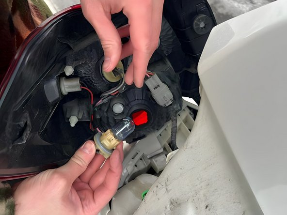

  7. 2014 Subaru Impreza Hatchback Brake light Replacement: crwdns2935265:07crwdnd2935265:01crwdnd2935265:02crwdne2935265:0 2014 Subaru Impreza Hatchback Brake light Replacement: crwdns2935265:07crwdnd2935265:02crwdnd2935265:02crwdne2935265:0
    • To remove the brake light, twist the light bulb socket counterclockwise.
    • The bulb should come out as shown in the second image.
  8. 2014 Subaru Impreza Hatchback Brake light Replacement: crwdns2935265:08crwdnd2935265:01crwdnd2935265:01crwdne2935265:0
    • To remove the bulb, gently pull out the bulb from its connector.
  9. 2014 Subaru Impreza Hatchback Brake light Replacement: crwdns2935265:09crwdnd2935265:01crwdnd2935265:01crwdne2935265:0
    • Gently insert the new bulb into the connector.
    • Carefully insert the bulb, as the bulb is made of glass it is susceptible to breaking and cutting you if a lot of force is used to insert it in the connector.
