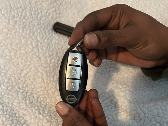

    • Flip your key to the back of the key fob.
    • Remove the emergency key from the key fob.

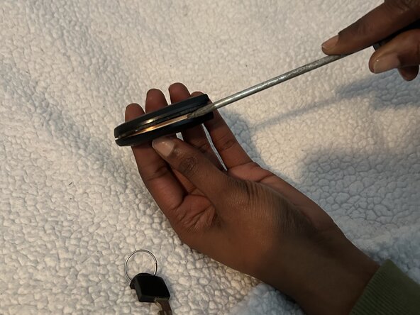

  2. 2014 Nissan Juke Key Fob Battery Replacement: crwdns2935265:02crwdnd2935265:01crwdnd2935265:02crwdne2935265:0 2014 Nissan Juke Key Fob Battery Replacement: crwdns2935265:02crwdnd2935265:02crwdnd2935265:02crwdne2935265:0
    • Gently insert a spudger into a corner of the key fob casing.
    • Push up the spudger to remove both halves of the key fob from each other.
    • Be careful when trying to find a good corner to separate the halves so that the spudger does not stab you.

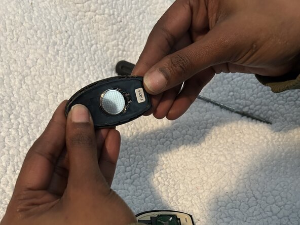

  3. 2014 Nissan Juke Key Fob Battery Replacement: crwdns2935265:03crwdnd2935265:01crwdnd2935265:01crwdne2935265:0
    • Open up your key fob and look at all the components in your key fob.
    • Pay attention to what side the old battery is facing; it will be helpful for the next step.
  4. 2014 Nissan Juke Key Fob Battery Replacement: crwdns2935265:04crwdnd2935265:01crwdnd2935265:01crwdne2935265:0
    • Remove the old CR2032 battery.
    • Pay attention to what side the old battery was facing.
