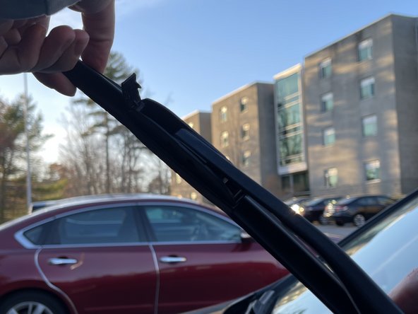

    • Go to the driver’s side windshield wiper.
    • Pull the driver's side windshield wiper away from the windshield.
  2. 2014 Infiniti QX50 Windshield Wiper Replacement: crwdns2935265:02crwdnd2935265:01crwdnd2935265:01crwdne2935265:0
    • A tiny clip is holding the blade in place. Push the clip up towards the arm of the wiper and push up.

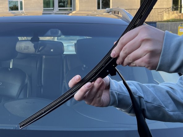

  3. 2014 Infiniti QX50 Windshield Wiper Replacement: crwdns2935265:03crwdnd2935265:01crwdnd2935265:03crwdne2935265:0 2014 Infiniti QX50 Windshield Wiper Replacement: crwdns2935265:03crwdnd2935265:02crwdnd2935265:03crwdne2935265:0 2014 Infiniti QX50 Windshield Wiper Replacement: crwdns2935265:03crwdnd2935265:03crwdnd2935265:03crwdne2935265:0
    • Completely disconnect the old blade by pushing it a few inches from the arm.

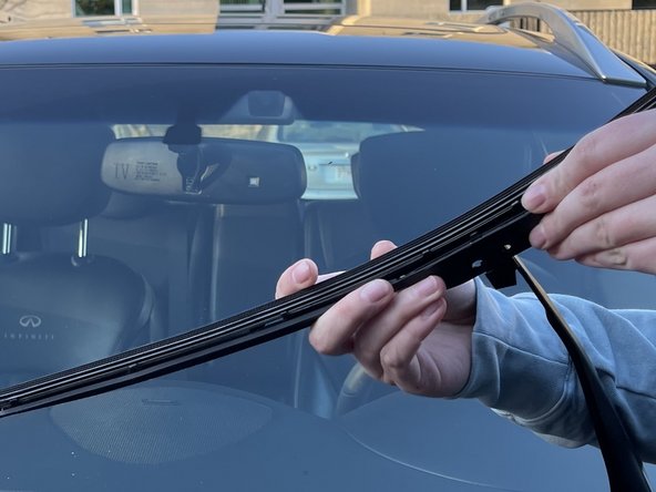

  4. 2014 Infiniti QX50 Windshield Wiper Replacement: crwdns2935265:04crwdnd2935265:01crwdnd2935265:02crwdne2935265:0 2014 Infiniti QX50 Windshield Wiper Replacement: crwdns2935265:04crwdnd2935265:02crwdnd2935265:02crwdne2935265:0
    • Position the new blade so the hook is toward the wiper clip.
    • Place the hook over the top of the attachment and lock the blade into place by pulling it towards the end of the arm.
    • Pressure should be applied so the blade can latch onto the hook.
