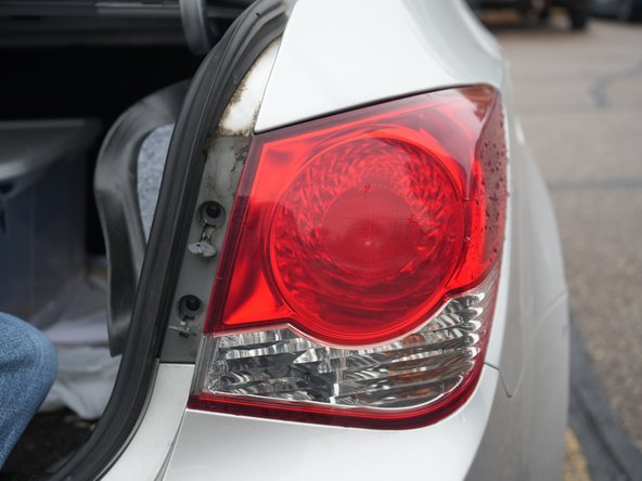

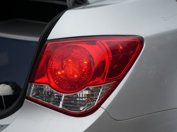

    • Open the trunk of the car.
  2. 2014 Chevy Cruze Taillight Bulb Replacement: crwdns2935265:02crwdnd2935265:01crwdnd2935265:01crwdne2935265:0

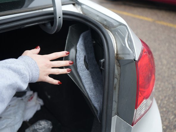

    • Remove the deck trim plug using needle nose pliers.
  3. 2014 Chevy Cruze Taillight Bulb Replacement: crwdns2935265:03crwdnd2935265:01crwdnd2935265:02crwdne2935265:0 2014 Chevy Cruze Taillight Bulb Replacement: crwdns2935265:03crwdnd2935265:02crwdnd2935265:02crwdne2935265:0
    • Pull back the trunk deck trim cover to uncover the taillight assembly.

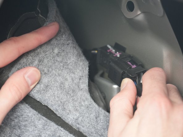

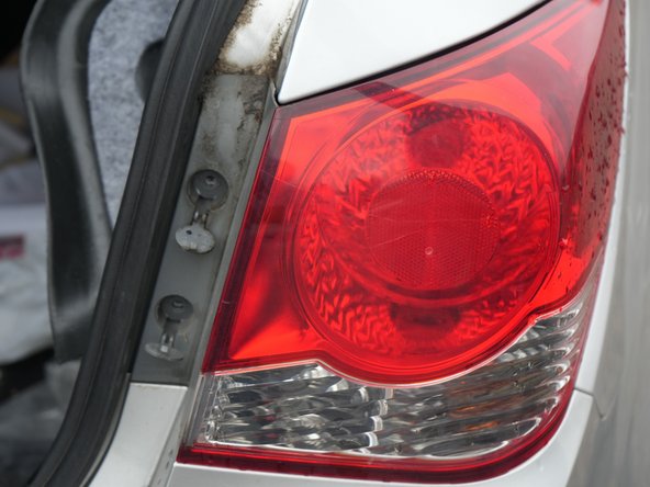

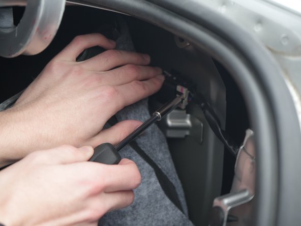

  4. 2014 Chevy Cruze Taillight Bulb Replacement: crwdns2935265:04crwdnd2935265:01crwdnd2935265:03crwdne2935265:0 2014 Chevy Cruze Taillight Bulb Replacement: crwdns2935265:04crwdnd2935265:02crwdnd2935265:03crwdne2935265:0 2014 Chevy Cruze Taillight Bulb Replacement: crwdns2935265:04crwdnd2935265:03crwdnd2935265:03crwdne2935265:0
    • Remove the grey plastic connector with a flathead screwdriver, gently sliding it off.
    • Unplug the taillight cable.

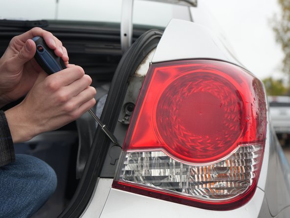

  6. 2014 Chevy Cruze Taillight Bulb Replacement: crwdns2935265:06crwdnd2935265:01crwdnd2935265:02crwdne2935265:0 2014 Chevy Cruze Taillight Bulb Replacement: crwdns2935265:06crwdnd2935265:02crwdnd2935265:02crwdne2935265:0
    • Remove the two screws with a Phillips head screwdriver.

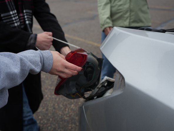

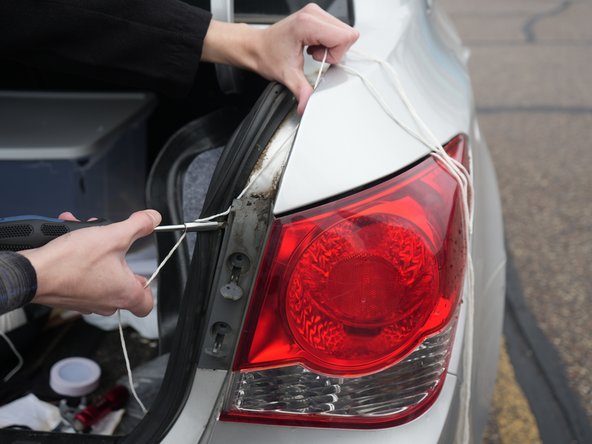

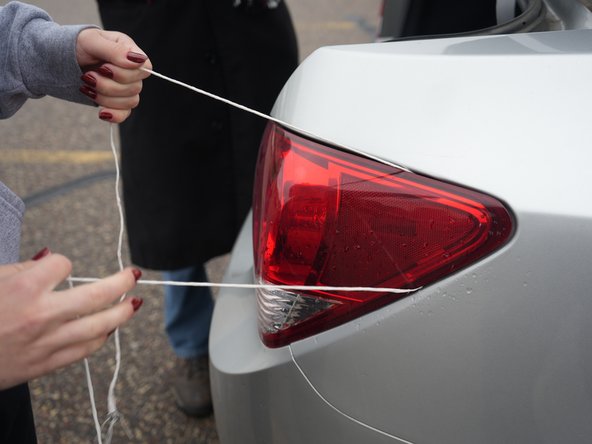

    • To remove the taillight assembly, first use a flathead screwdriver to pry the taillight up and slide a piece of twine beneath each side.
  8. 2014 Chevy Cruze Taillight Bulb Replacement: crwdns2935265:08crwdnd2935265:01crwdnd2935265:02crwdne2935265:0 2014 Chevy Cruze Taillight Bulb Replacement: crwdns2935265:08crwdnd2935265:02crwdnd2935265:02crwdne2935265:0
    • Once the twine is securely behind the taillight assembly, take hold of both pieces of twine and pull straight back to pop the assembly out.

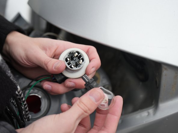

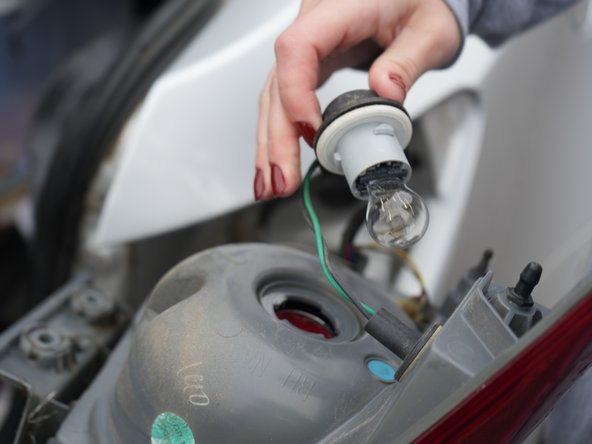

    • Remove the bulb socket from the taillight assembly by turning it counterclockwise.
  10. 2014 Chevy Cruze Taillight Bulb Replacement: crwdns2935265:010crwdnd2935265:01crwdnd2935265:02crwdne2935265:0 2014 Chevy Cruze Taillight Bulb Replacement: crwdns2935265:010crwdnd2935265:02crwdnd2935265:02crwdne2935265:0
    • Remove the defective bulb.
    • If the bulb does not come free, use a flathead screwdriver to press against the plastic base of the bulb and leverage it out of the socket.
    • Do not press the screwdriver against the bulb itself. This may cause it to shatter.
    • Once the bulb has been removed, be sure to place it in a safe area where there is no risk of it breaking.
    • To dispose of the defective bulb, wrap it in a secondary layer of disposable packaging (such as paper towels within a plastic bag) before throwing it away.
    • Guidelines for disposing of halogen lightbulbs can vary. Be sure to double-check your local disposal guidelines before throwing the defective bulb away.
