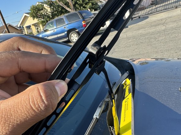

    • Lift the Wiper Arm: Gently lift the driver's and passenger side's wiper arm away from the windshield. It should stay in a raised position on its own.

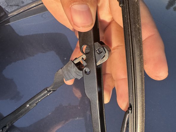

    • Examine the Wiper and Inspect the connection between the wiper blade and the wiper arm which is a hook.
    • Look at the red circle in the picture you will see my thumb and index finger placed on the release tab. add pressure and pull downward towards the hood of the car to release the old wiper.
    • Also Examine the Wiper Attachment: Inspect the connection between the wiper blade and the wiper arm. Look for the release tab circled in orange in the picture.
    • Then do the same step as did on the other wiper slide the wiper blade downward, away from the wiper arm. This should detach the wiper blade.

    • Attach the New Wiper Blade: Take the new wiper blade and position it at the end of the wiper arm where the old one was removed. Ensure the attachment mechanism aligns with the connection point on the wiper arm.
    • Secure the Attachment: You will have to reverse your steps on how you removed it, so now you will pull up and make sure the hook/arm attaches with the wiper. To insure you got you will hear a click sound. If so, you are set.
    • Passenger side: Do the same step, make sure the hook/arm is in position and just push up and it will lock in place.
