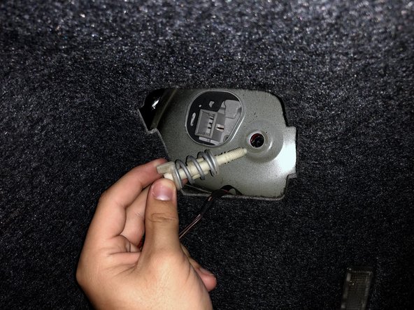

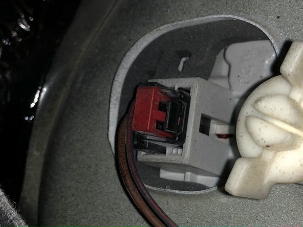

    • Pull back on the red tab to release the securing mechanism.
    • Remove the plug.
  4. 2013 Volkswagen Passat Rear Blinker Light Replacement: crwdns2935265:04crwdnd2935265:01crwdnd2935265:03crwdne2935265:0 2013 Volkswagen Passat Rear Blinker Light Replacement: crwdns2935265:04crwdnd2935265:02crwdnd2935265:03crwdne2935265:0 2013 Volkswagen Passat Rear Blinker Light Replacement: crwdns2935265:04crwdnd2935265:03crwdnd2935265:03crwdne2935265:0

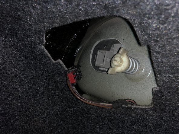

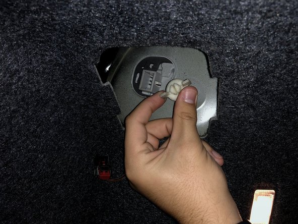

    • Rotate the plastic screw counter-clockwise until the screw becomes loose.
    • Remove the plastic screw.
    • The screw is the only part that holds the tail light to the vehicle. Be sure to hold the tail light from outside the vehicle so it does not fall and become damaged.

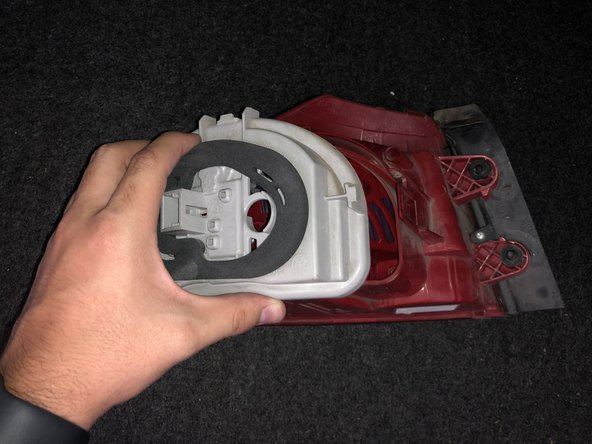

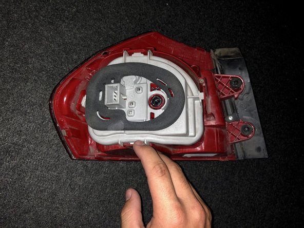

    • Undo all 4 clips securing the grey plastic piece to the red plastic piece.
    • Lift up and separate the grey piece from the red piece.
    • There are still wires connecting the two pieces. Do not disconnect the wires.
